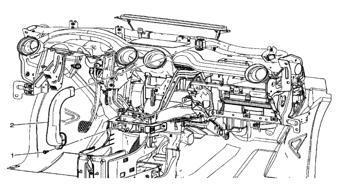

Another issue is that between the right vent and left vent in the center stack there is about a 10 degree difference. One will feel icy cold and the other will just feel cool with the icy one being the right vent. This is super strange to me as the car does not have dual zone climate control. It may be a vent ducting problem as the air gets warmer the further you go from the evaporator. Anyone else dealt with this? I also don't believe I've ever changed the cabin air filter so I'll do that as well.

Vent door actuator motor, change the cabin air filter.
Old Jun 9, 2022 | 04:42 PM
Posts: 26,533
I know the line drawing is hard to see but look closely for answers to your questions. The ducts are connected by simple friction and sealed by open cell foam, that ends to dry out and rot over time.

Ahh I had no idea that the two far side vents were fed by the same source, cool! Dang that picture is giving me flashbacks of replacing the actuators in my Trailblazer. It'd have been easier to just break my arm in 3 places to get at that driver one
