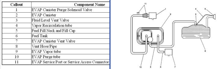

There are two fuel lines one liquid and one vapor. Unless the canister is flooded it'll be the return line.

Vapor from the tank goes to the intake manifold, it is not a return line like on a diesel.
Vapor from the tank goes into the charcoal canister where it is stored until the EVAP purge valve opens, the vapor is then sucked into the combustion chamber and burned.
The only way there could be fluid in the vapor line is if the charcoal canister somehow got flooded with fuel. That would cause other more serious symptoms. When that happens from overfilling the tank the usual result is charcoal pellets in the tank.

I was referring to the fuel return. If the can is soaked it will leak raw fuel.

We have explained the two lines. The vapor line is for your EVAP system and the other are for fuel delivery from the gas tank.
