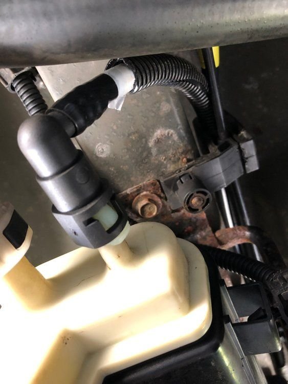

Old Jun 21, 2025 | 03:46 PM
  #28
Posts: 40,083
Here’s the other end of that vapour line it connects to the EVAP canister up under the rear axle area of the HHR
