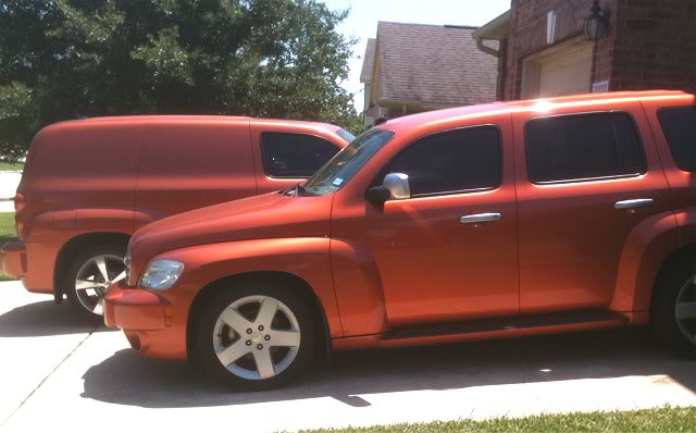

Hello,
I think Im addicted to upgrades :)
So far Ive done the following to my 08 LS Panel.
ADDED
1.) Steering wheel radio controls
2.) Stock USB Radio head - scrapped the PAL
3.) Added stock Sub Woofer - added wires too :)
4.) Factory Bluetooth.. Just replaced VCIM moduel
5.) Factory DVD headrest add-on
6.) Factory Running Boards
7.) Factory Fog lights. got the harness off ebay
8.) SS front grille
9.) LT exhaust tip
10.) Rear Seat and belts.. removed cargo box
11.) Factory Premium floor mats
13.) Painted mirror covers to match body
14.) Chevy Cobalt nickel shift knob
15.) 09 Shifter (leather boot)
16.) Rear sway bar
17.) 18" Impala Rims
18.) Rear bumper step pad
19.) Factory mud flaps
20.) Blacked out Depot headlights
21.) IPCW - Bermuda Black LED Tail Lights
22-?) I have the roof rack and cross bar...not sure if I want to install it.
Proly missed something.....
I still have the LS badge on the back. Maybe I should change it to a LT :)

Were the fog lights easy to install? Do they use the factory switch? What about the sub? Where does that plug in to anyway? I looked at mine earlier today and there is nothing behind that panel.
I'm looking for the parts to add the steering wheel radio controls. The switch isn't a problem, it's the harness and trim piece I can't find. I did find a 6 disc changer though.
Is that an XM/Onstar antenna? That's the other mod I want to do, was yours factory? Any idea if that would work with aftermarket head units? Any more pictures of your car?
Mike

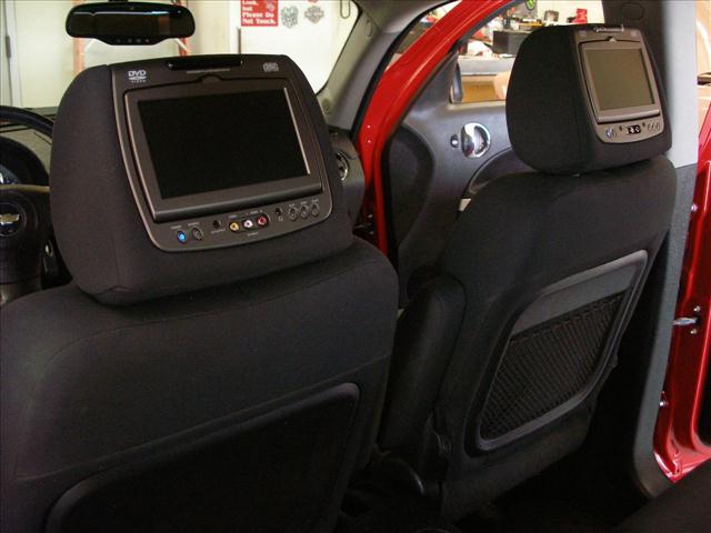

I bought 2 different sets from members here. $400 for a set.
Heres a pic what they look like.
Invision DVD headrest.
Not my HHR
[/URL]
Set on ebay now. hope its your color :)
http://www.ebay.com/itm/2007-Invision-Chevrolet-HHR-Dual-Headrest-DVDs-/111356964918?pt=US_Car_Monitors_w_Built_In_Player&hash=item19ed647036
Not my HHR
[/URL]Set on ebay now. hope its your color :)
