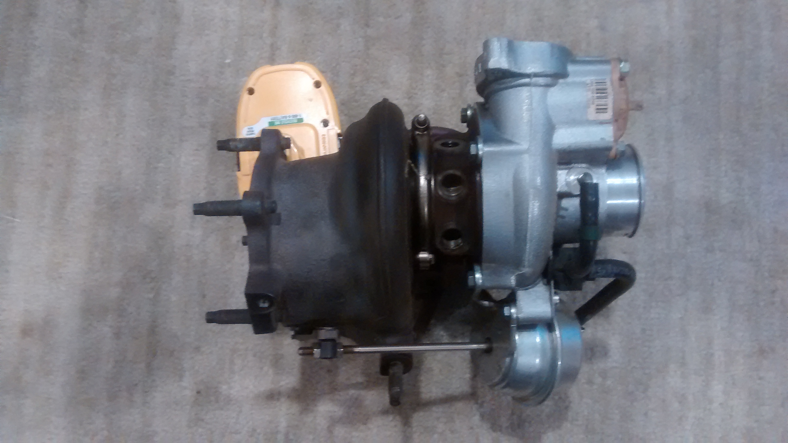

RJ_RS_SS_350 May 12, 2017 07:53 PM
The Sky is not a transverse-mounted engine, and therefore has a different turbo. Here are pics of Powermizer's turbo that is on his LDK, going into his Sky.https://www.chevyhhr.net/forums/atta...d-img_0195.jpg
https://www.chevyhhr.net/forums/atta...d-img_0196.jpg
And here's a pic of my spare HHR turbo
https://www.chevyhhr.net/gallery/fil.../3/0/turbo.jpg
EDIT: upon further research, the turbo Powermizer is installing is not the factory config. But I still think the Sky is different. https://www.chevyhhr.net/forums/2-0l...e8/#post808819
RJ_RS_SS_350 May 12, 2017 08:37 PM
1 Attachment(s)
Upon FURTHER RESEARCH, lol. They may be the same. Here is another pic from Powermizer's thread, of a factory config(I think)?
https://www.chevyhhr.net/forums/atta...ild-image.jpeg
And here is another pic of my turbo, at a similar angle.
Attachment 21630
EDIT: I've sent a PM to PM(lol), hopefully he'll chime in here or get back to me.
