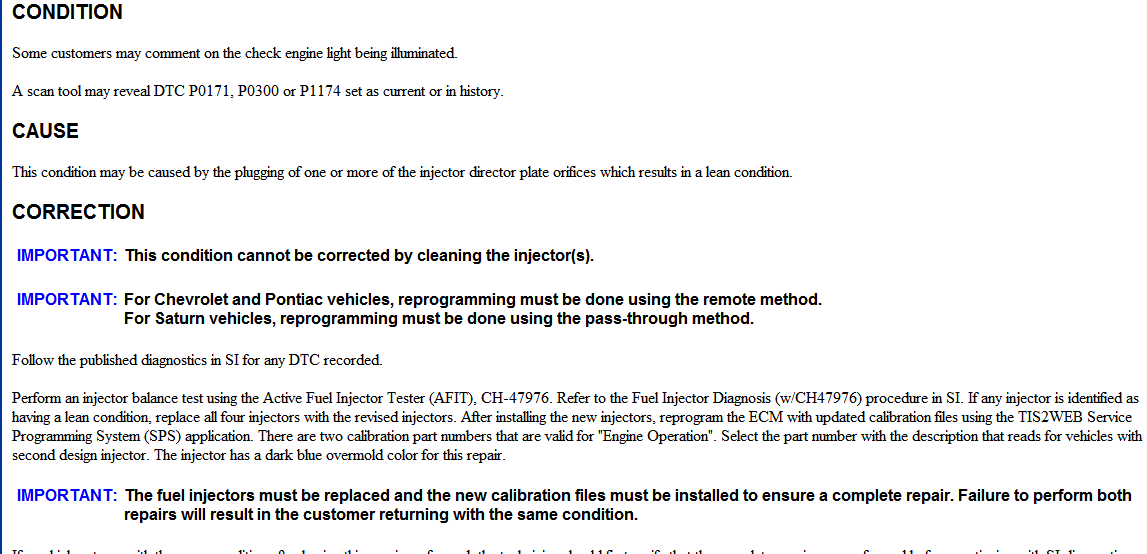

There is a TSB re P0300 in 2006-2007 2.4L. Basically the fix is use a different injector and new program. 08-06-04-001B.
New part number 12625029
excerpt:

I was unaware! I wonder if the ones I bought were a revised version and I just need to program
