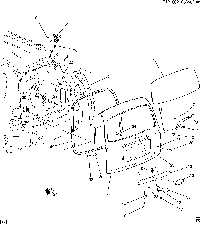

The rear wiper on our SS has pretty much deteriorated beyond use. I finally remembered when I has the car and had the time to stop at the auto parts store.
I decided to change out the wiper in the parking lot even though it was below freezing. I knew better, but I went ahead and did it. Of course when taking off the base cover, (#10 in the below diagram), the piece that goes along the shaft snapped off.
One of the things that has bothered be about the rear wiper is that you're no able to pull it very for off the glass when cleaing the rear glass. now, with that piece missing, the wiper will stay 90 degrees from the glass. The cover snapped back in place, and seems secure.
I'm going to watch it, and if it holds up, I'll make the same mod to the '07. If not, it looks like the part is under $5, so I'll just replace it.

There's a tab inside that cover that people have been cutting off to allow the wiper to stand off the glass at 90*..... I did mine. Maybe that's what broke off yours?

That's exactly what broke off. I searched before posting, but didn't see anything about it. I wish I'd known years ago

For those wondering how to do it check it out here: Rear Wiper Mod

Cool!...... The cover stays on fine without that tab, so go ahead and do the '07

Did mine during very first car-wash, as I recall I just used needle nose pliers, grabbed the tab & gently snapped it off cleanly. No need for cutting.
time invested: 4.7 seconds
