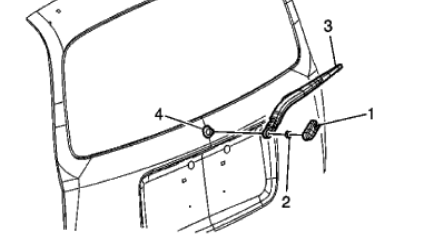

Check the 10 mm nut that holds the wiper arm to the motor, it might be a touch loose.

Loose nut. There is a cover over it that you have to pop off.
