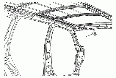

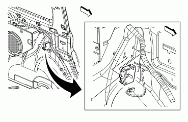

Originally Posted by db/sb
Why would it necessary to know the VIN in order to research the location of the receiver? The module that contains the receiver is located on the seat back cushion latch bracket which is behind the left rear quarter lower trim panel. You have to remove the rear seat to get to it. If you replace the module, the new one has to be programmed.
Originally Posted by Sno White
According to my 2009 FSM the RCDLR and the TPMS receiver are the same device and is located above the headliner next to the rearview mirror. Perhaps the early year models were different, such as your 2006?
2006-2007
2008-2011
