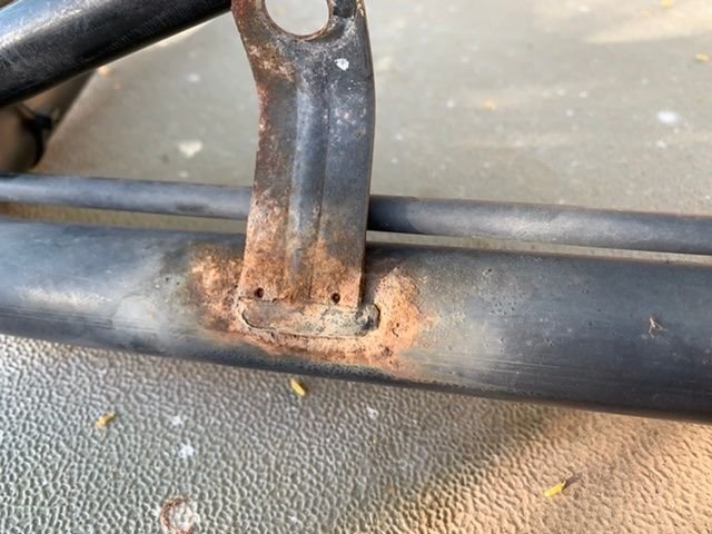

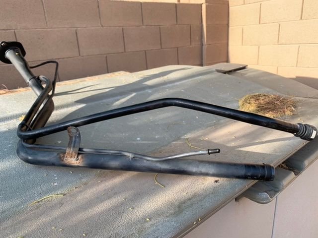

Here is another possible source of a fuel odor. Take a look at your fuel fill tube for heavy rust. My old tube had very heavy rust where this bracket was welded. With a full tank, there was a strong fuel odor at the right rear. One evening, I was lucky to spot a few drops of fuel on the driveway. When I crawled under the car and looked up, there was still a small drip of fuel hanging off the fill tube. Must be a small pinhole in the heavy rust area. My fuel odor problem is gone.
There must be a small pinhole in the rusty area.

I think you’re correctly looking at a very good possibility of the rust eating that tube . I often wonder if a gas compatible hose can be used to connect those two pieces after you cut out the rusty piece.

I wonder how such a bad welding job gets past QC.
