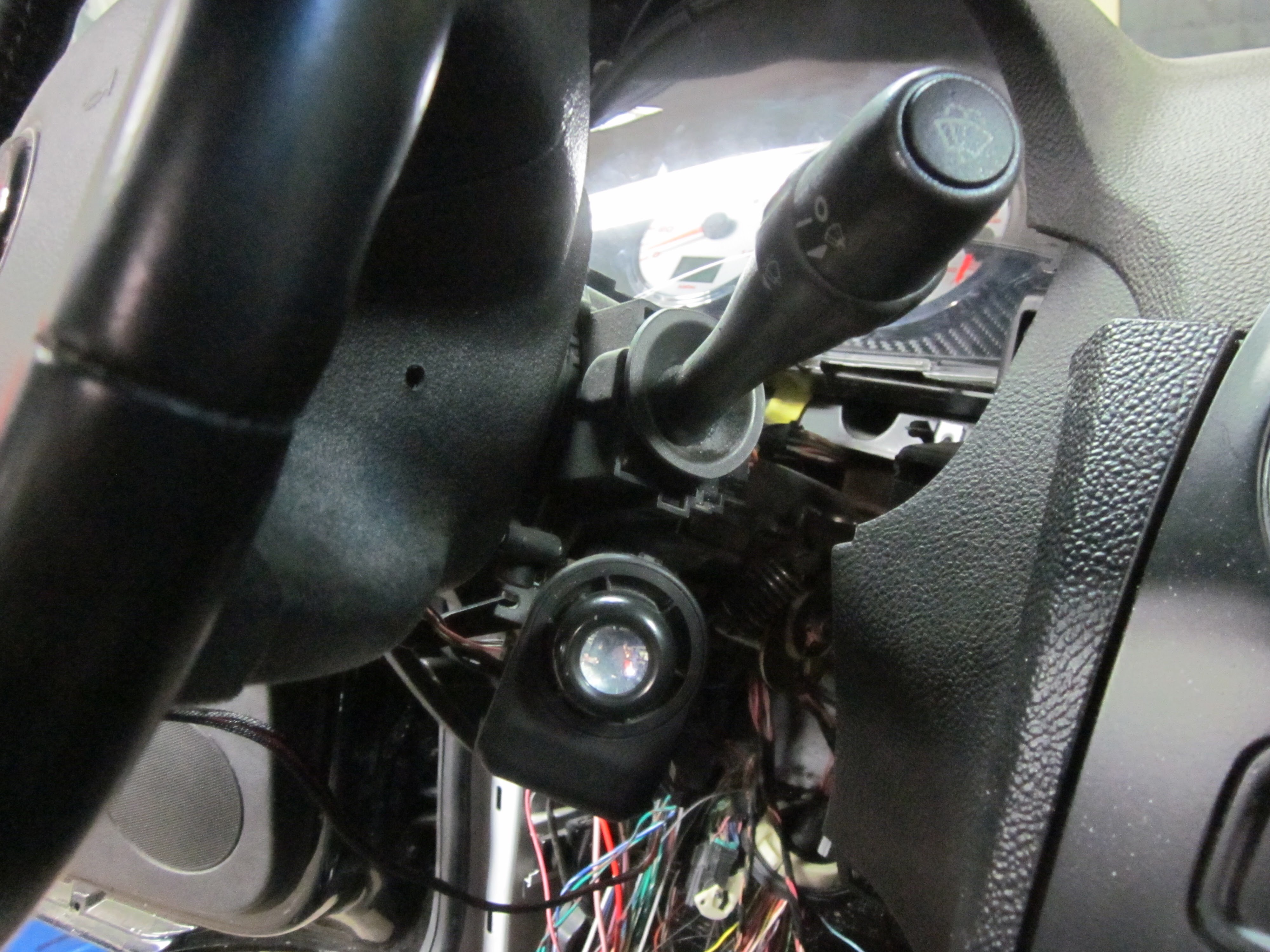

iStart installed
I mentioned this before but I don't think I've posted pictures of the iStart keyless ignition system. It has a remote that unlocks the doors and of course it does all the ignition chores too

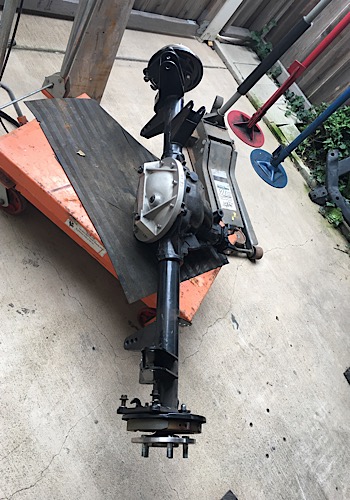

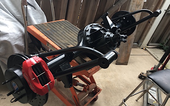

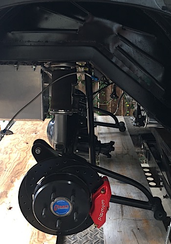

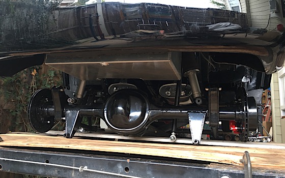

Sorry I haven't posted in a while. Thanks to Craig Gibson's excellent work, the wiring is complete enough for me to finish it and the engine runs. I'm now replacing the Camaro rear axle with a Currie 9" rear end. I've got several days to complete this over the 4th of July weekend.. it should be sitting back on its feet in a day or so, barring any problems. The first photo shows the Camaro rear axle out of the car. It's a slow process massaging this new unit into position.
