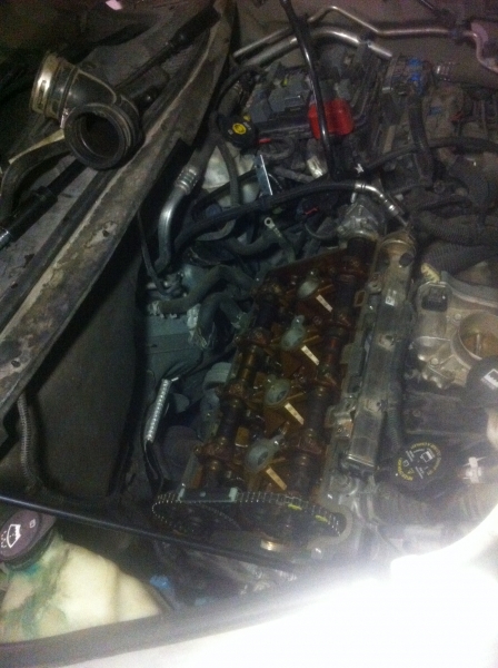

Installed the new head, old rockers, and old lifers, and new cams. Hybrid of rockers and cams, we'll see how it works for now. Something to tinker with later too.
Installed new timing chain
The green dot next to the black link has me scratching my head, and going WTF...
Now I have to put it all back together, and thankfully the Haynes manual for the GF's car is the same engine as this. I just need to take some time to figure it out. like WTF does this go to?
And where the funk is the 8 pin connector that goes to the throttle body here?

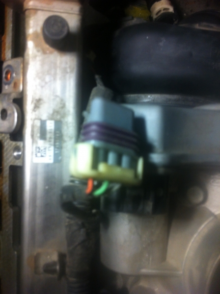

And this 4 pin connector? Where on earth does he go?

Gee victweezy,
The all black one on the oil filter looks like the MAP connector off of the manifold. Maybe to the Intake Cam Position Sensor.
That other blue one with purple rubber might go to #4 injector. I can't tell for sure, but the throttle body connector looks like a 4 pin from here.
Your throttle body is not the same as mine. It looks like it's mounted backwards compared to my 2011 2.2L. Come to think, the old 2008 2.2L was the same as the 2011. Meaning the electrical connection is on the oil filter side.
I'm guessing the dot indicates the release link.

What a day... I found where almost all of the loose connectors go with a few exploded diagrams. There is still one that seems a to be just floating in the breeze though. It goes to the brake booster, with a white connector and looks like it is the vacuum line (pictured above) for the brake booster. It runs under a connections coming out of the fuse box, and just ends. I would think with it being a vacuum line it would go to the intake manifold somewhere but it seems to come up just short... I'll have to do a bit more digging.
