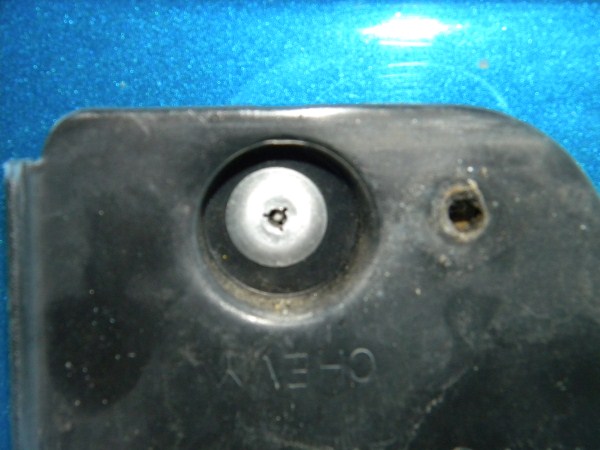

Okay, mine is this 3 shaped thing reminds me of a peace sign... my dad is/was a GM tech and doesn't have a tool that would get the thing off. He said they are a type of rivet.
He said he will drill out the bolts for me once it is a bit warmer.

what is this conector ??

Looks like a big head pop rivet to me.
I would drill the head with a 1/8" drill bit just to flush with the parent metal, then use a punch to knock it through.
Since I work on aircraft, we use a lot of Cherry-Max fasteners, 1/8" is the interfered size for most skin to rib connections.

Looks like what was on my lic. plate holder on the front bumper before i removed it , Talvanos right , Just drill it out.
