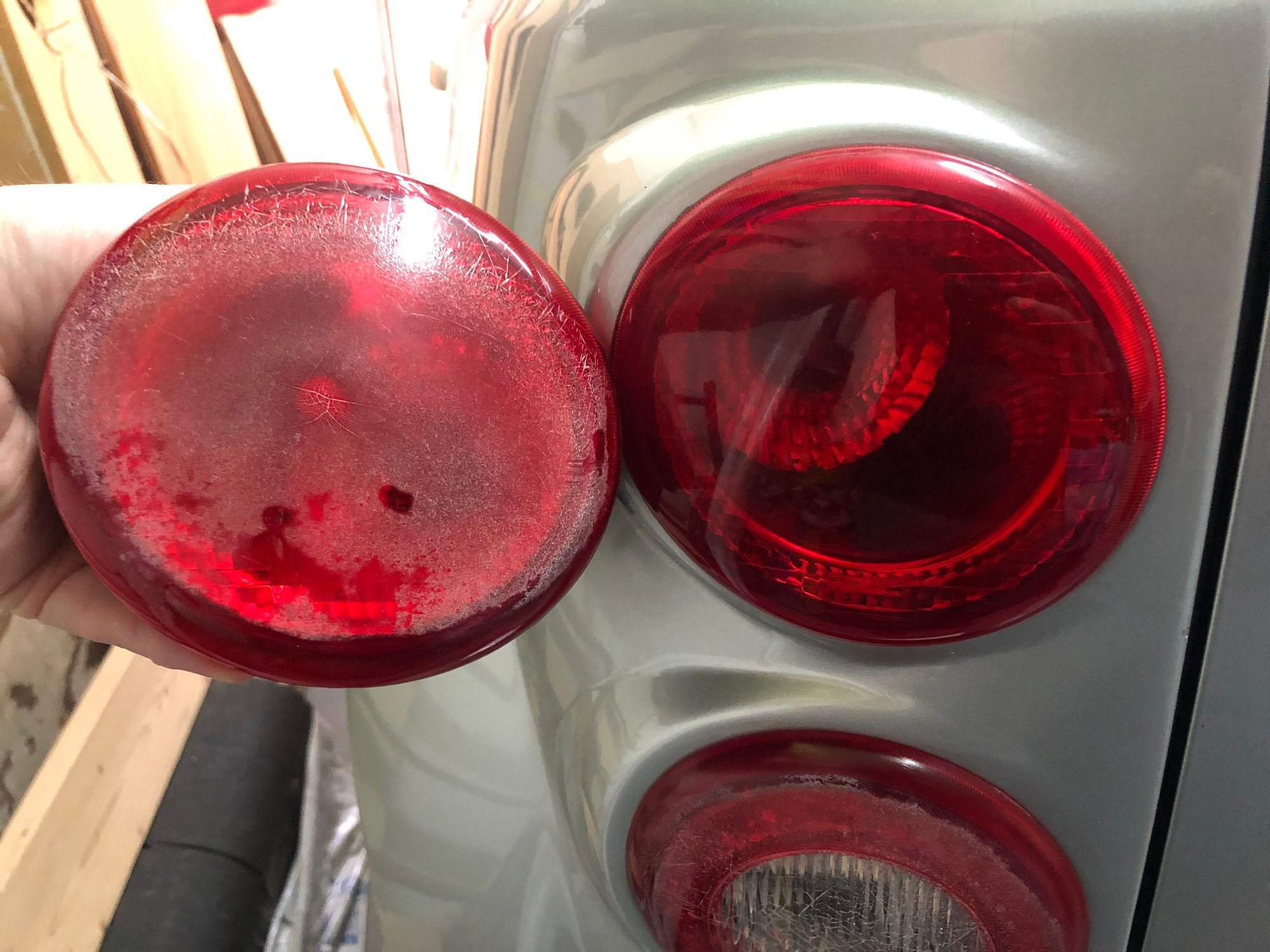

Replaced my upper tail lights that I bought from Oldblue awhile back. My old one is on the left. But first, I used Mothers for a quick polish with my drill and a buff pad. Turned-out pretty good! Next to see how it does on headlights!

Looking good! Glad you’re getting them spiffed up and installed!
PittKrew- I love Mothers products.. Nice job..
