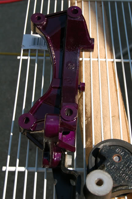

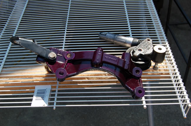

I started to test paint some brackets, Gotta get them all Cleaned up and decide what parts to paint and clear coat and what parts get just clear coated, and what ones just get Cleaned up.
All this kinda little Detail stuff has gotta get Done before I install the supercharger, so I am now working on getting all the used parts ready for the install.

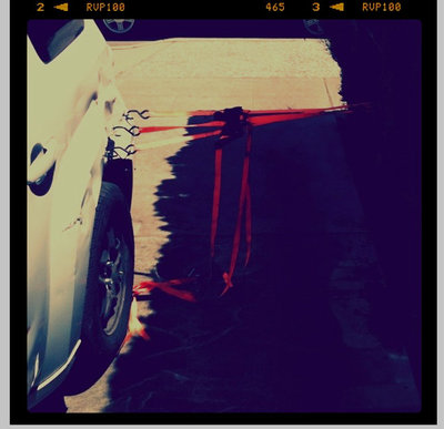

Thanks! It's been lots of work but worth it now. It wasn't long ago that the quarter panel was being ratchet strapped into shaped by those cypress trees in the first picture.

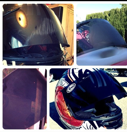

Check out another thing I did yesterday.
Recently I got hit while riding my motorcycle (watch the video)
http://www.youtube.com/watch?v=aYzTAd9AWHU
One of my damages included the visor of my topotheline Arai, not wanting to spend the $70 on replacement I decided to try to fix it. Pretty decent 3" scratch in the center; no way.
800, 1200, and 2000 grit wet sanded and finished with lexan polish on a cotton puff die grinder. 1/2 hour later nearly new again.
