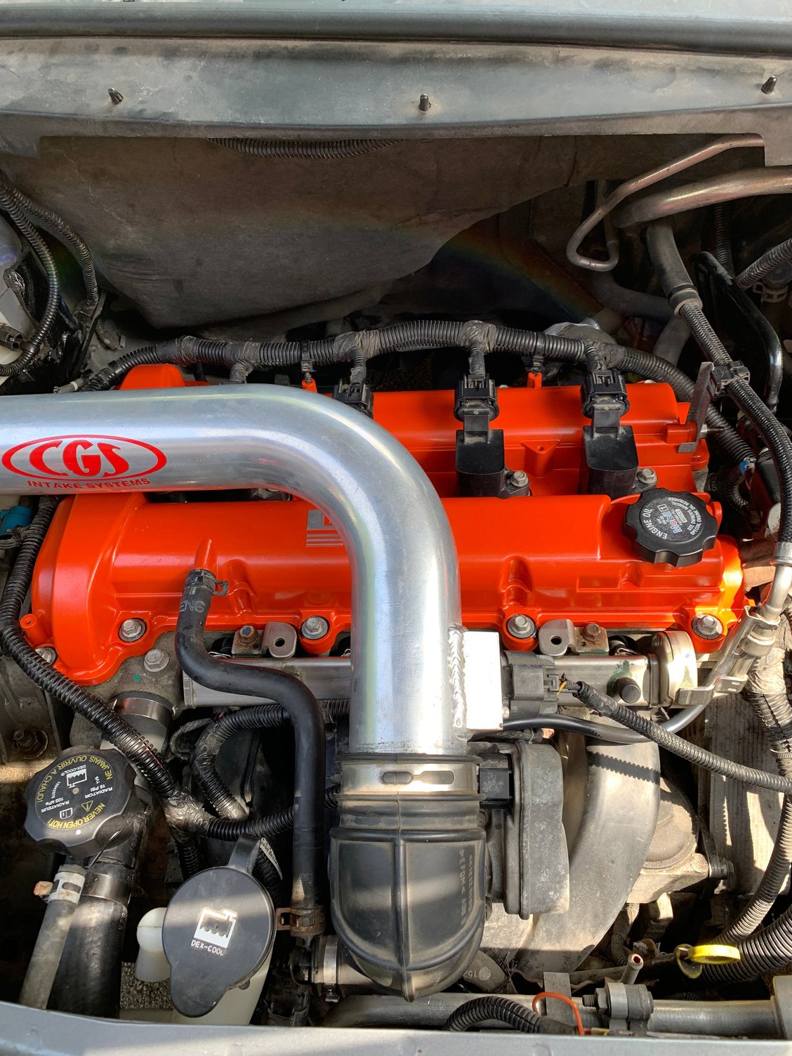

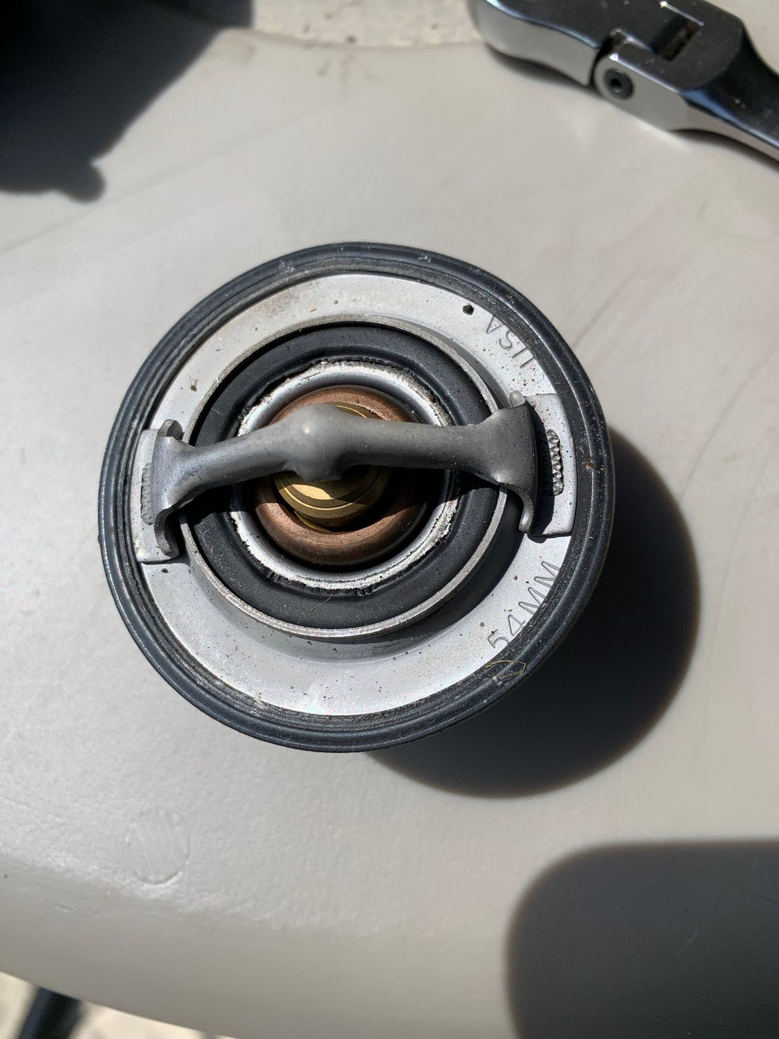

Drove back to the_shmoo’s place to finish up his 2006 2LT we changed timing and balance shaft chains on Wednesday, today we changed thermostat, rad hoses , radiator and Dexcool, then started it up! He primed the oil pump , with fuel pump fuse #13 out , turned the engine over 3 times, put the fuse back into the fuse box and he turned the ignition key, it fired right up!
here’s some photos
New powder coated valve cover, installed

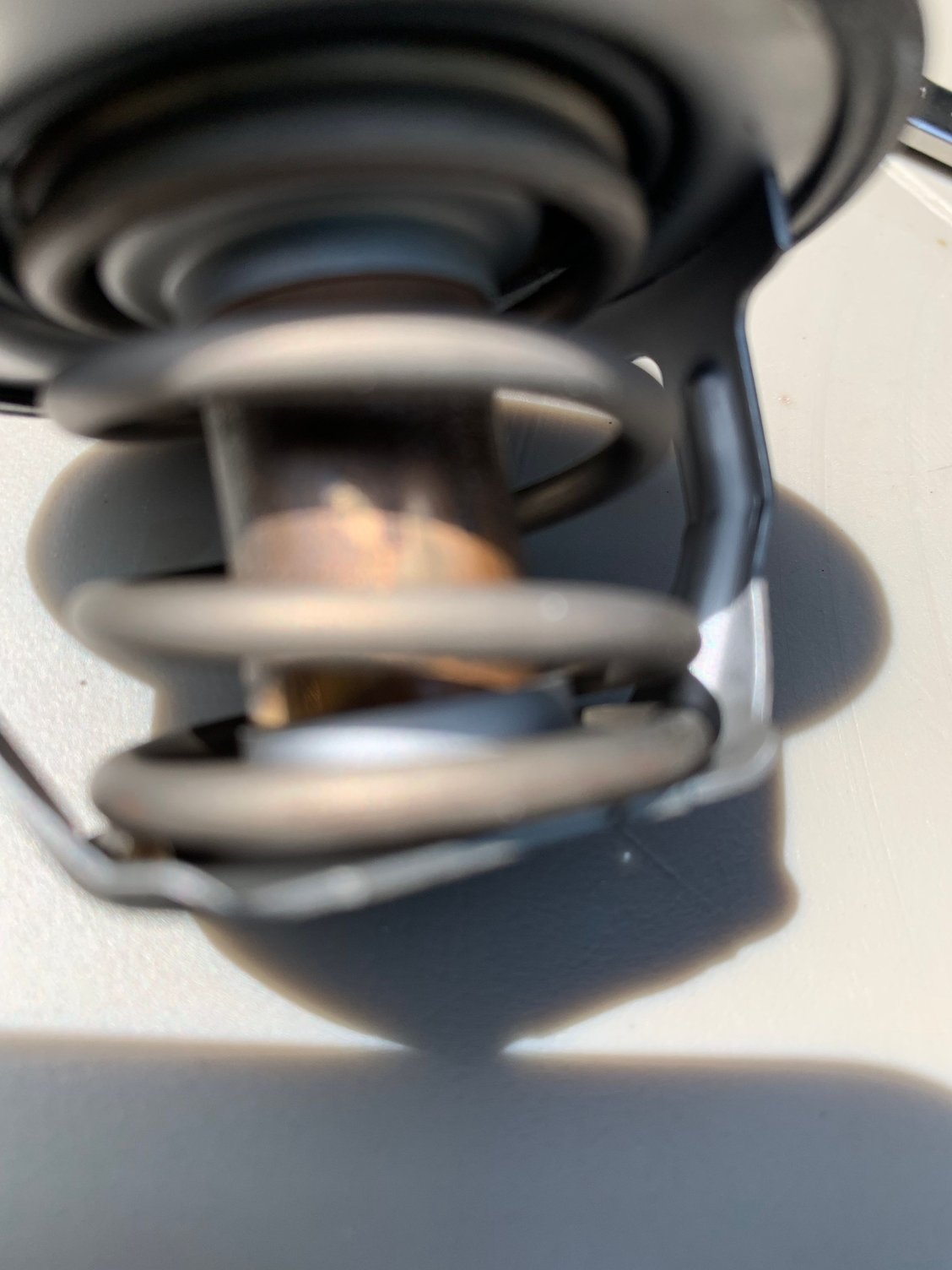

The 16 year old 131-158 thermostat

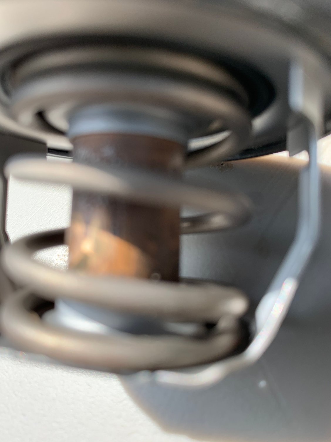

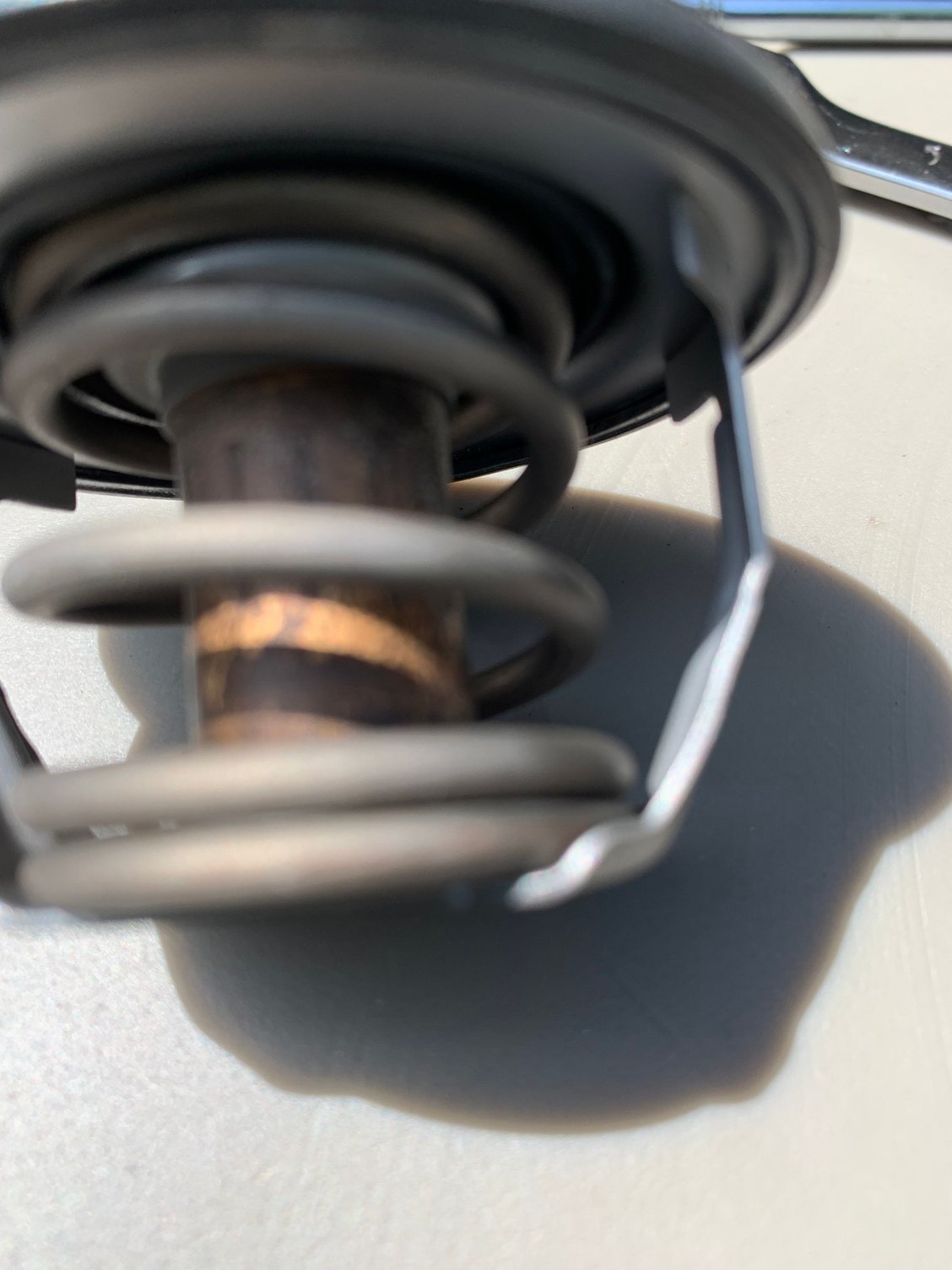

You can see some marks on the brass where it was sticking
A little closer look
The other side, these are marks indicating a failing thermostat.

Today, I replaced the thermostat, there were marks on the brass part similar to the photos I posted for the_shmoo’s HHR ,
only his was 16 years old! Mine just 20 months. I then jacked it up, put it on safety stands and drained the engine oil, then removed the oil pan!

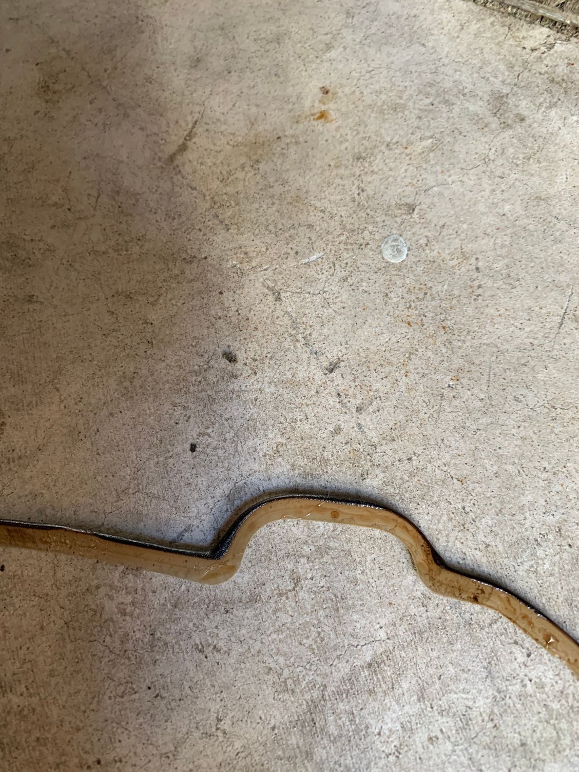

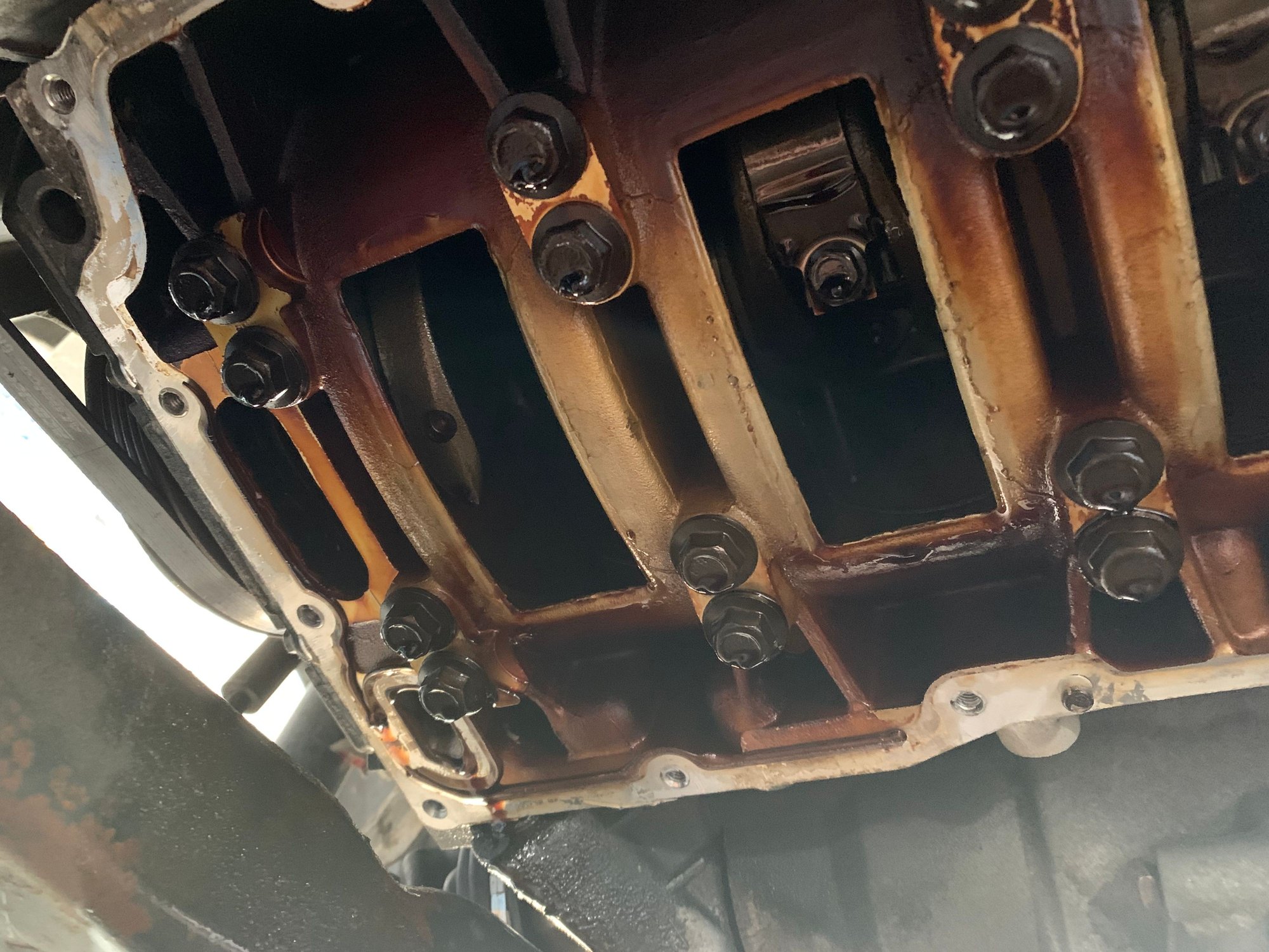

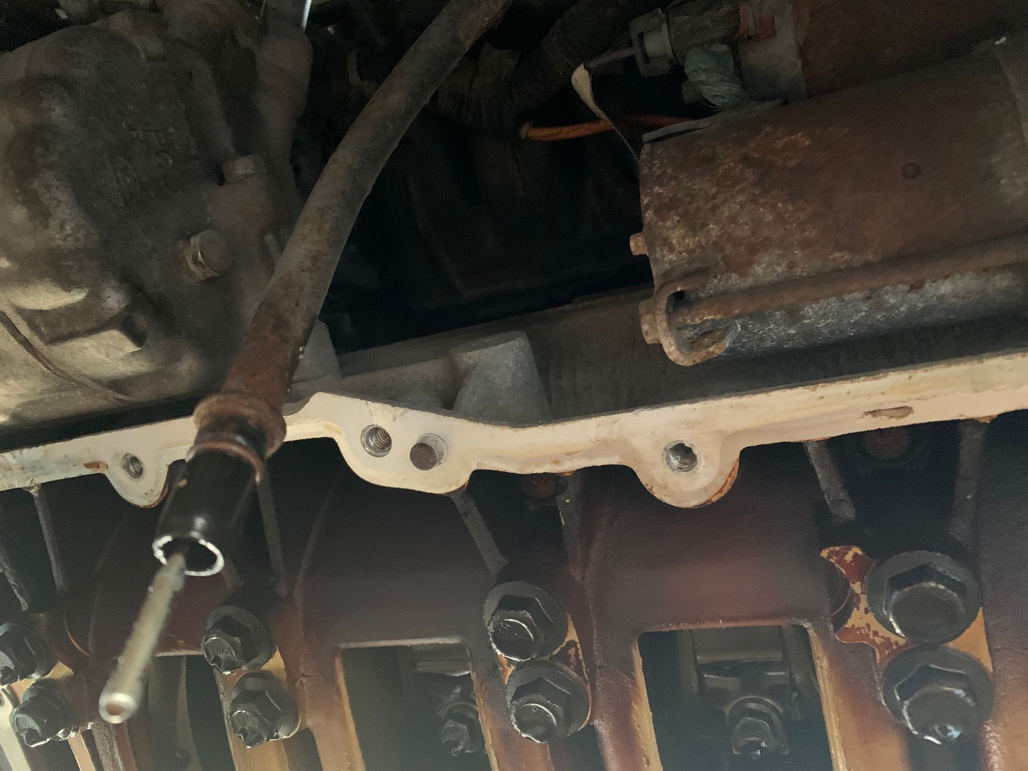

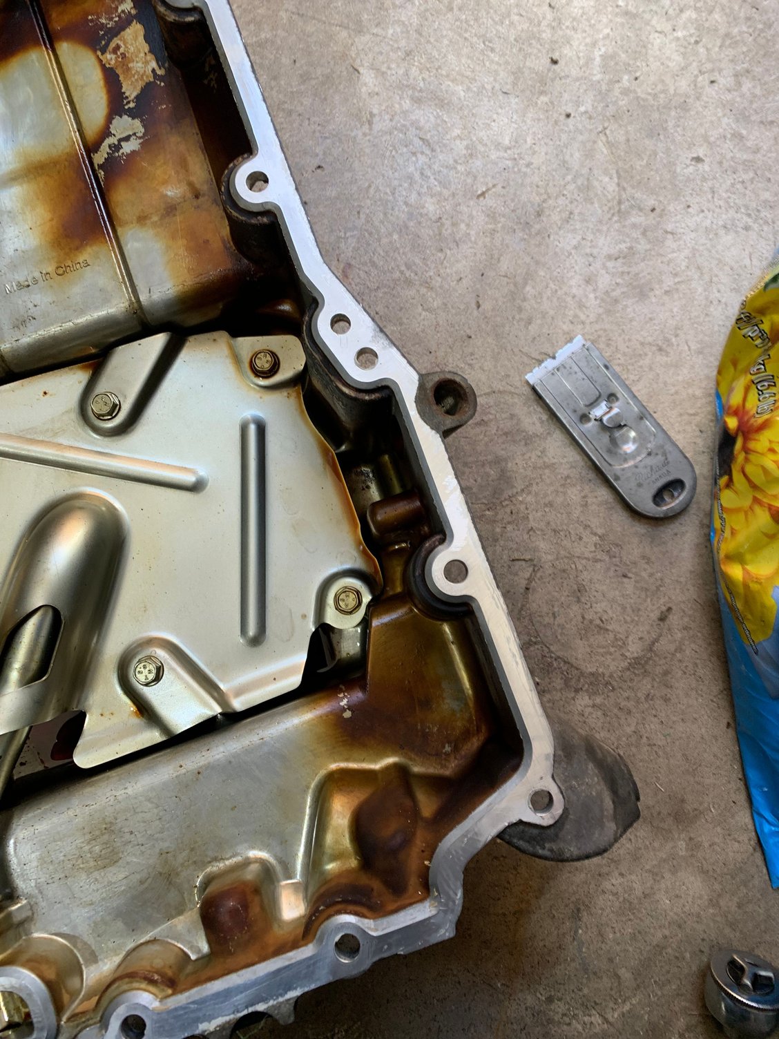

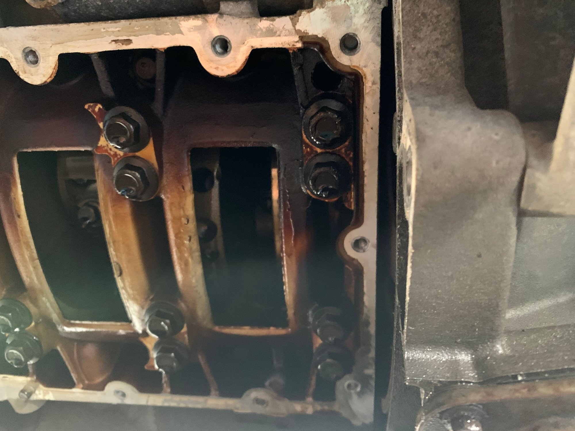

Me either, this stuff is still wet where the components clamp together along the oil pan and engine girdle rails, it wipes off with a rag and brake cleaner spray.
The oil pan rails , still need to be cleaned
The dipstick tube and front side of the engine

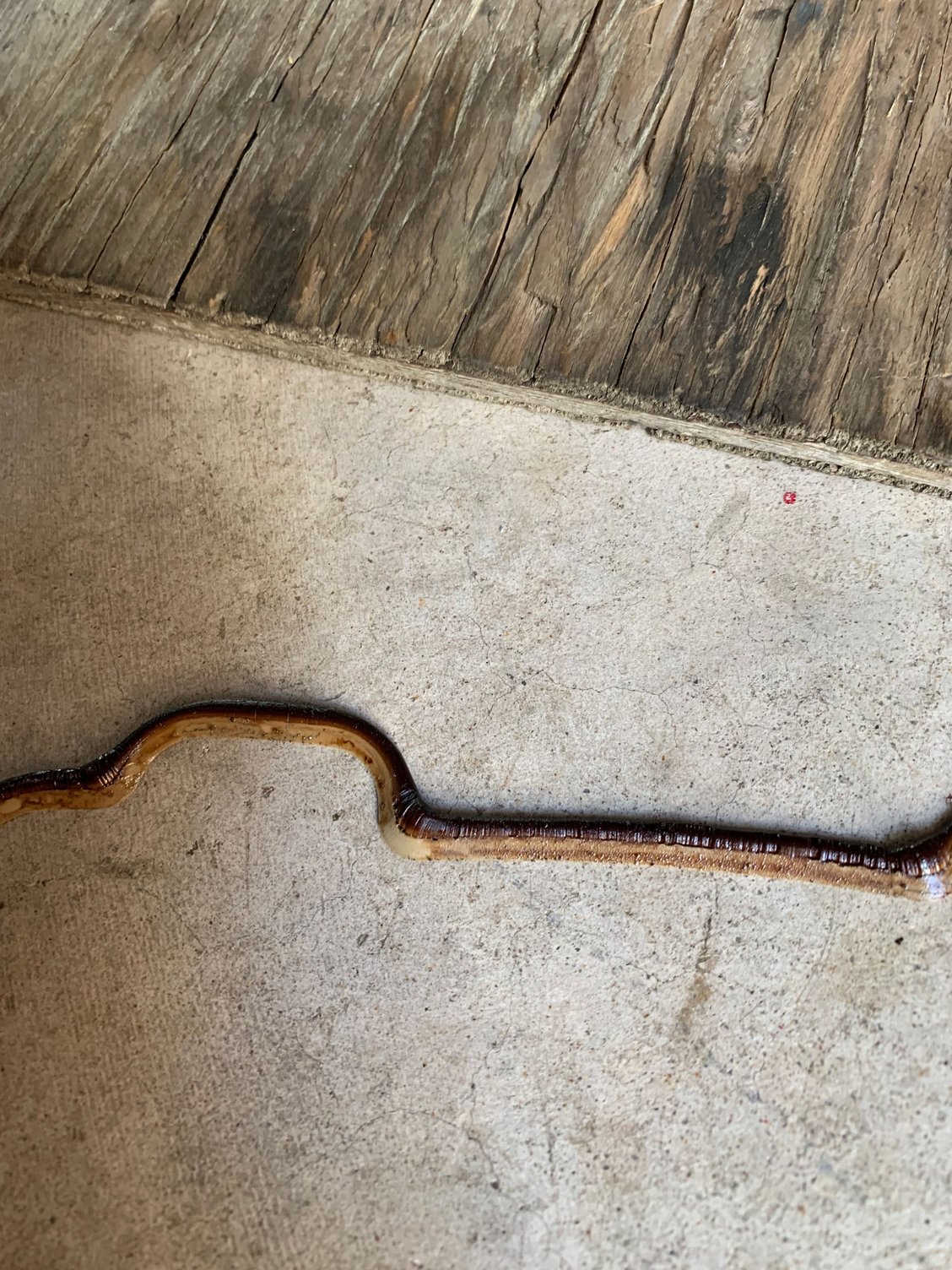

This was a piece that peeled off the oil pan
Piece of the sealant excess inside the engine

The surfaces cleaned up perfectly with brake parts spray, then Dawn and water, I applied the Permatex Black Oil resistant RTV silicone and put the pan up in position, finger tightened two bolts, and let the sealant firm up while, I threaded in the rest of the pan bolts , then finger tight only for the 4 large bolts that attached to the transmission, the one bolt for the A/C compressor, I then installed a new oring on the dip stick tube and reinstalled that, put the bolt back thru the oil dipstick tube bracket that mounts to the intake manifold, reconnected the brake booster vacuum hose, reinstalled the throttle body, I cleaned it last night! Then I had lunch, after 3 hours, I torqued the oil pan bolts to 18 ft/lbs those large bolts to 65 ft/lbs. I added oil and reconnected the positive terminal on the battery.
