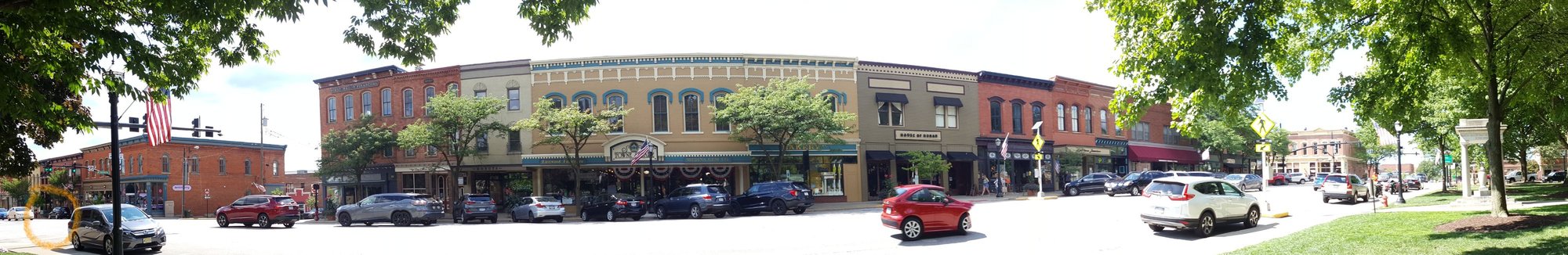

Sunday we took the SS on a drive mostly through beautiful Ohio farm country to pick up a set of used black Sparcos for her. Shopped the Medina town square, had amazing pulled pork samishes at a local BBQ joint. Four hours on the road, only encountered one Amish buggy. Good day.

Nice pics & merged together.. Cool.
Red car in the middle is awfully short though...

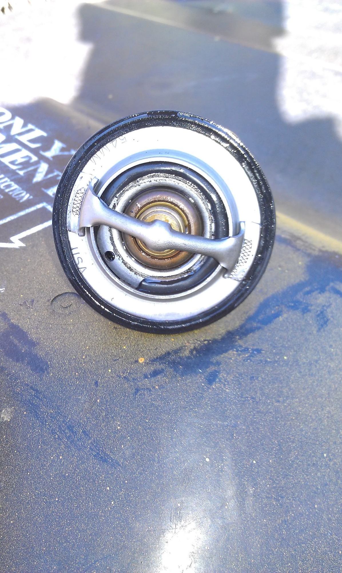

The old thermostat is from December 2020, so no warranty. We used to test thermostats by opening the valve and putting a piece of string thru it, then the bring the water to boiling noting the water temperature.
In this case , I simply have to inspect the thermostat to see if the valve is open as it seems to be stuck that way.
the original was and you could see the rubber was causing it to stay open.
If it looks anything like this^^^^ we’ll know it’s not the ECT sensor
Greybeard- Saw that, figured it is maybe a new fangled 'lectric car.. or a merged pic.. LOL

Thanks! Didn’t need to merge images, though, just put the fone in pan mode. The distortion of moving objects can be hilarious, with people’s heads disembodied, etc.
