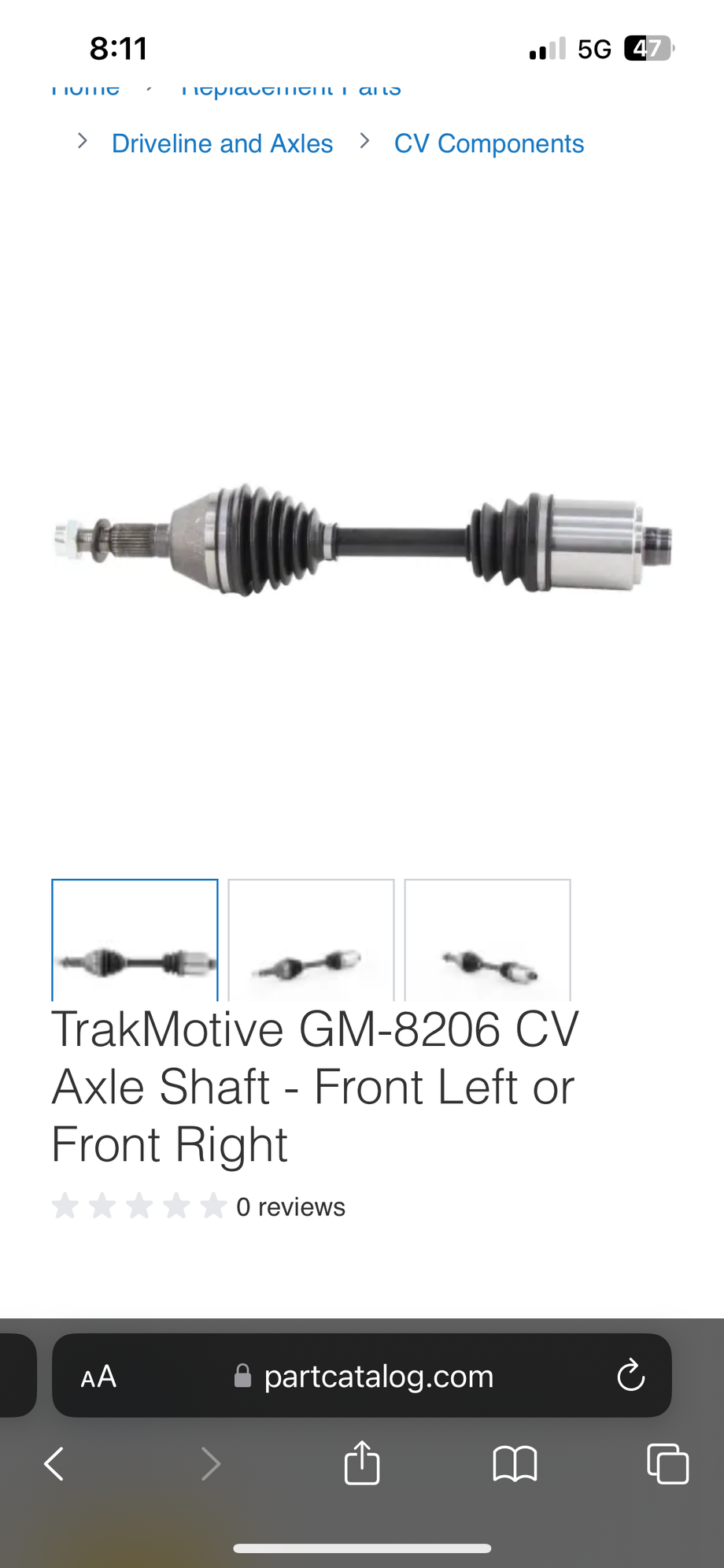

CV axle
would this be right?
Old Mar 13, 2025 | 09:27 PM
  #114
Posts: 26,539
They look the same to me.

The axles are the same, but the passenger side has a splined stub shaft between the CV and the automatic transaxle

"They look the same " was in relation to the 2 posts, not the 2 parts. GM-8206 is the part number in both posts, I don't understand why the question was asked. I guess failure to notice the preceding 111 posts of the thread is the cause.
Everyone that has done the job knows about the stub on the passenger side. There are vendors that sell Left and Right axles for LS/LT that don't require the stub. SS uses different axles than LS/LT. The stub is considered part of the trans not the axle.
