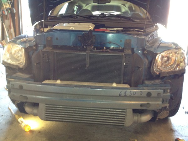

CEL P0107 Error
I'm back to report that I upgraded my intercooler to a ZZP. I also upgraded the hot side charge pipe to a Taliaferro. The car is running ok but i keep getting a CEL with a P0107 - manifold absolute pressure / barometric pressure circuit low input. Gas mileage has also suffered. Apparently, the computer is confused.
The code returns even after having it cleared.
Is there something I can do about this error to keep it from returning?
