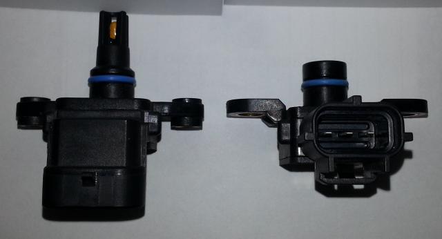

In case you didn't know, there are two map sensors. One on the intake manifold and another on the lower charge pipe behind the radiator. I would check the orings for damage and make sure the sensors are seated properly

X2 what XtremeSS said. Those little O rings should be checked.
Here's the stock upper and lower sensors, which, by the way, are sitting in my office gathering dust.

This forum is awesome. I'll check the o-rings of both. By the way, I only checked the seating of the lower map sensor.
Attachment 16526
If it turns out that one or both of these map sensors are bad, how much for the ones gathering dust?

Resolved the CEL P0107. Since I hadn't checked the upper MAP sensor, that's where the problem was found. I only checked the lower MAP sensor because I thought I had bumped it while installing the ZZP intercooler.
The upper MAP sensor connector was not snapped tight. I suppose it has been that way since the engine was replaced! Probably initially had enough connection to not throw a code. When I lightly pulled, it came right off. I snapped it back in place. Still had the CEL but it went away after driving around.
