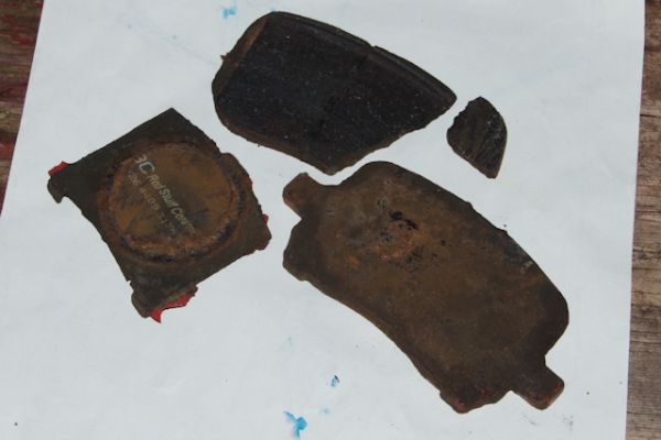

High-res photo
12.03.16.18.19.46 | Flickr - Photo Sharing!Some pieces of the pad had fallen out. The other three wheels had similar results.
I would just chalk that one to bad luck as I have only seen a couple issues and never anything like that.
Like I said with mass production every one has an issue now and then. But in the big picture most brake companies seldom have issues.

Sorry you got a bad set but they are very rare.
