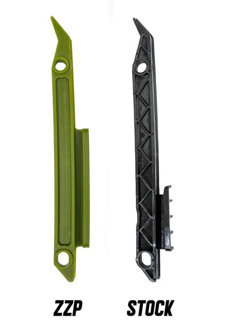

P0017 is an emergency. While theoretically the solenoid valve or actuator could cause this, it almost always means the timing chain has jumped. You have been lucky. Do not start it Do not crank it, do not let a mechanic crank it, until it is fixed. If it jumps additional teeth, the result will be bent valves. Even limping to the shop instead of towing would be a gamble. Countless crached valves are due to failing to head P0016/17. You have been warned.
If the seller recently replaced the chains, they may have bungled the job. If they installed with the exhaust can sprocket a tooth or two off (I don't really know how many teeth off will cause damage, maybe only two for all I know,) that would explain the code, and why it hasn't crashed the valves yet. Or the tensioner is defective or installed incorrectly. If the dealer sold this car with the P0017, shame on them. They likely knew they were selling a time bomb.
If you have researched this, you know it's pretty easy to remove the valve cover and check for timing chain tension and get a peek at the front guide.
Next chain job I'm going to try this: https://zzperformance.com/products/z...ng-chain-guide
Apologies but I don't remember the source of this pic. Pretty sure it was here.

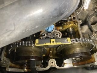

Hey Guys! I really appreciate the feedback so far. Was out of town and got really bad cold/plus busy at work so finally got a chance to dive into the car. The a/c in my shop broke and its 121 degrees real feel here in Dallas so been rough but fun. I'm currently in the middle of putting in a 4th bmw 4.4 v8 with timing chains done and blew the motor on my vette(machine shop has it but i pulled it out) so this actually is a little more enjoyable bc its not such a PITA.
Anyways I attached a small video to show what play I have in the chain. Also I don't have any wrenches bigger than 15mm at my house so going to shop tomorrow to get some big ones to rotate the cams clockwise or something to try and turn the crank in order to see how the cam sprockets line up. Yall might be able to tell with pics i took.

Supposed to be at 10 & 2 but havent turned crank to check. Looks like they will be. The guides look in good shape but the chain doesnt have marks like the timing chain kits do.

Took a while to get a video up but here is a link to the slack in the timing chain - not sure if this is too much?
