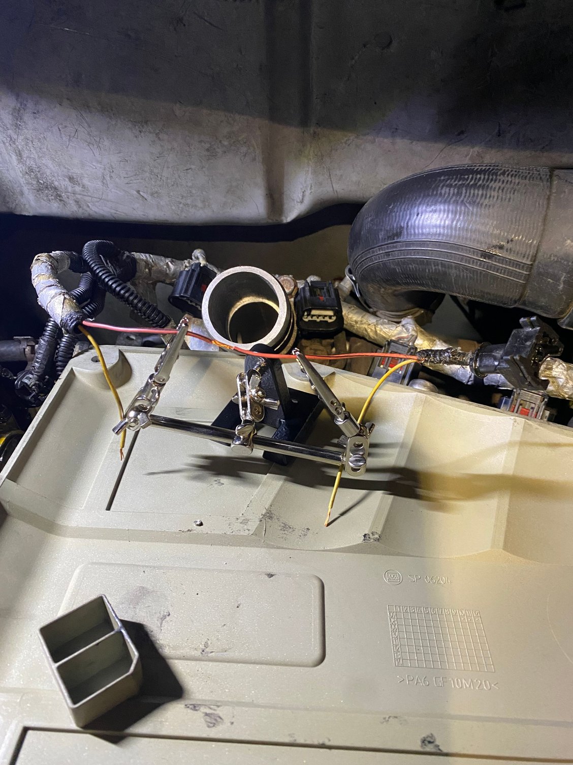

Pulled the cover off again and timing was still good and replaced with a new tensioner from GM. The one they sent me last week was already activated.
Also started going through wiring to find shoddy crimp jobs. Will have to go through more but the wastegate solenoid went away after soldering.
Reset codes via Bluetooth and my phone. Didn’t have time to check with my autel but instead of the P0014 I have the P0017 again apparently. Maybe camshaft position sensor? I did swap out the powerworks exhaust solenoid with an AC delco and no changes.
i do have 15lbs of boost now and the car has really woken up.
Guides and chain look new (previous owner said timing chain and water pump were new)but may end up just swapping them out with kits mentioned.
O2 sensor wiring is probably torn up too. Looking like the exhaust was removed and they did not twist then O2 counter clockwise before tightening it back in. I always give them a few twirls so they aren’t twisted when tightened.
