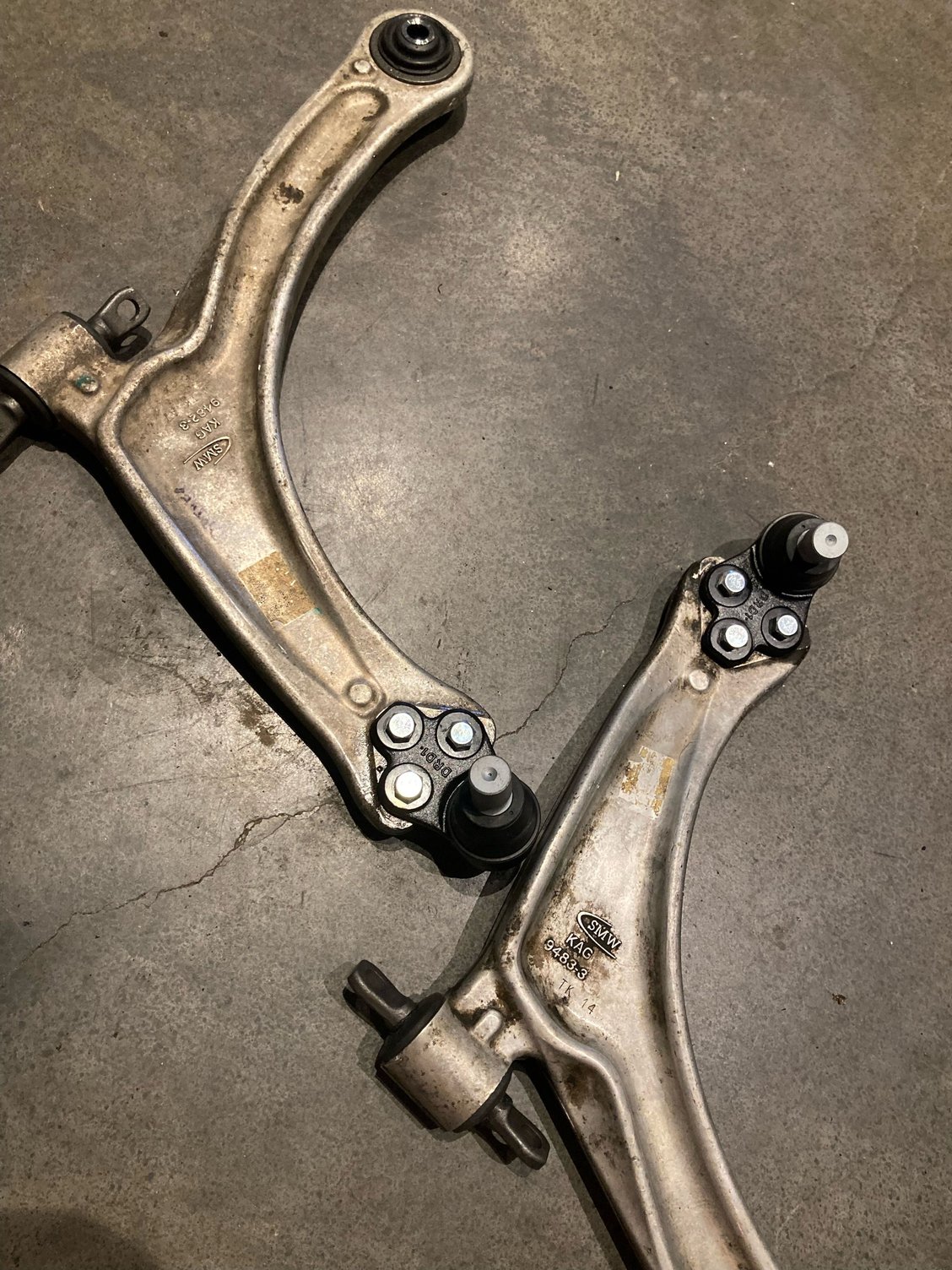

Wassup guys! Just wanted to check in and give an update. Have added 7K miles since I acquired my HHR SS and its been great! I've done 2 oil changes with mobil one, put new rotors/pads(and flushed the darkest green fluid i've ever seen out), and knocked out some suspension bits. The lower control arms were a PITA to put new ball joints on with having to machine out the old ones. Swapped in new strut mounts but probably need to get some new struts, the old ones were wore out but didnt help as much as i wanted. Just ordered new sway bar end links and tie rod ends. Slowly but surely its getting better and better to drive around but just don't have the time to tackle everything at once.

Hope you got the right ball joints, only available from overthetopperformance.com.

According to the photo, if I zoom in the letters and numbers match DRD1
Here’s a closer look
nice to see the Moog bushings in place
