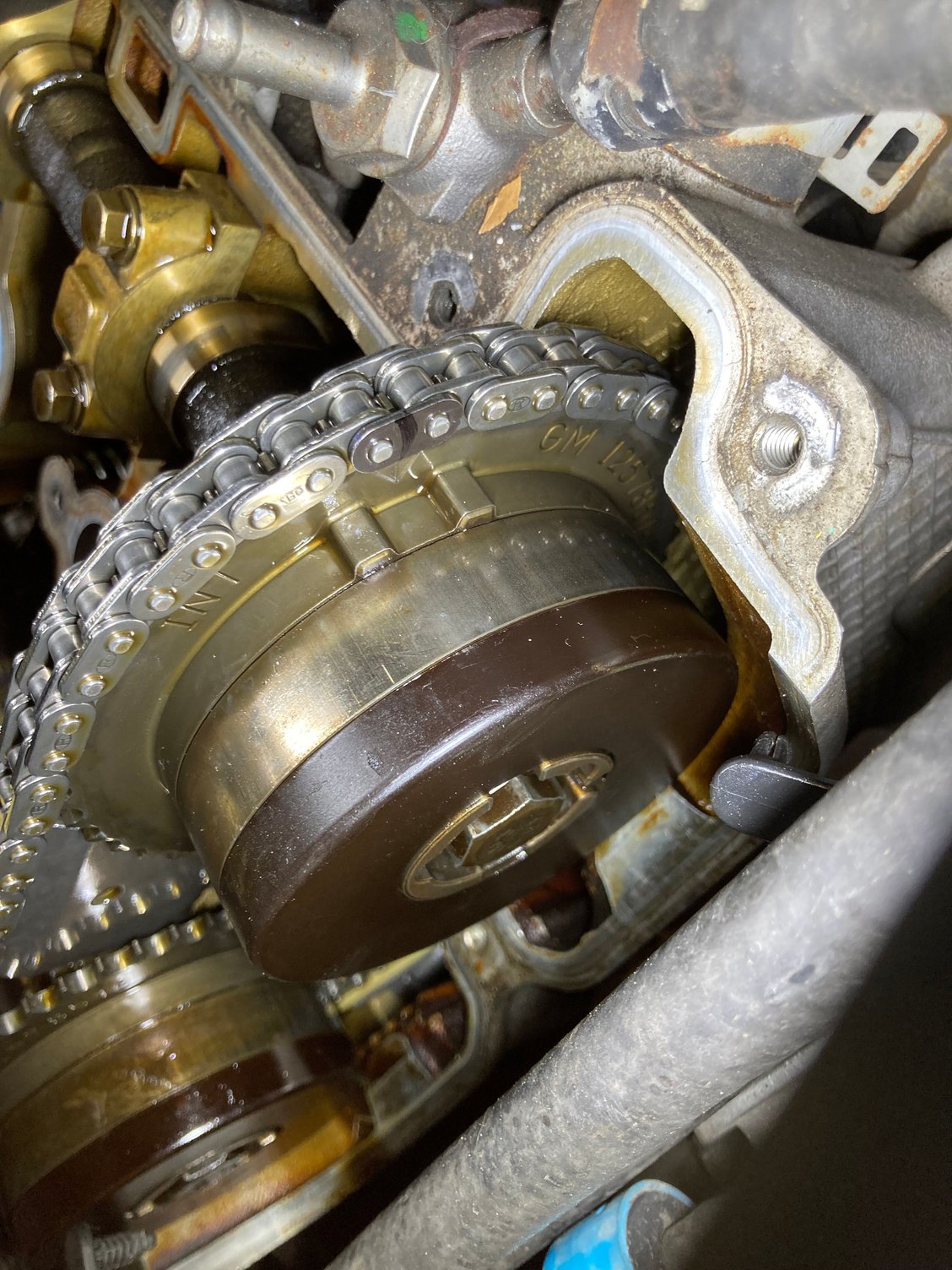

P0017 remains an urgent concern. It almost always means a mis-timed exhaust cam. Maybe alway, not almost, IDK. With deferred oil changes, valve part of a solenoid solenoid valve can gunk up as can the cam phaser, but your case looks pretty clean.
I don't know how to determine with absolute certainty that it's timed correctly without taking the cover off, BUT you can check the relationship between the two cam sprockets by counting teeth chain links.
In the video the chain slack does not look like it's enought that it would allow the chain to jump. Make me suspect that they bungled the chain job. You might as well forge ahead and remove the front cover.

I don't know how to determine with absolute certainty that it's timed correctly without taking the cover off, BUT you can check the relationship between the two cam sprockets by counting teeth.
In the video the chain does not look like it would allow the chain to jump. Make me suspect that they bungled the chain job. You might as well forge ahead and remove the front cover.

Yes there is slack in that timing chain. I would change it for sure. For the 2.0 Turbo you do not change the balance or timing crank sprockets, those are SS specific. So Ofer the chain kits with out sprockets
Cloyes 9-4201SX and 9-4202SX. That way you aren’t tempted to change sprockets and mess your engine up

holy crap this saved me time, the tire gave me torque to turn it 50+ times to try and get my marks lined up . Plus was able to pop towels out of spark plug holes to check compression.
You need AC Delco 41-108 (iridium) plugs. No substitutes. Check them if you must (carefully, they're easily broken) but they're pre-gapped. Modders with really high boost reduce the gap but that risks breaking them.
The "sensors" of which you speak are not sensors, they're the VVT solenoid valves. They sense nothing. (I care only to avoid confusion.) The two camshaft position sensors are on the front and back of the head, drivers side.
ordered plugs and a coil today
Cloyes 9-4201SX and 9-4202sx. That way you aren’t tempted to change sprockets and mess your engine up
so once I turned the passenger wheel all slack was out, I guess the valve springs backed a little. Super tight.
took me a while to get the colored links on the sprocket marks. Used a sharpee to help and the exhaust sprocket is 1 tooth off. You guys were right.

Ordered a pair of Dorman cam bolts. Plan is to check TDC with screw driver, ziptie the intake cam and chain together, pull chain tensioner, remove top guide, remove exhaust cam sprocket bolt, realign one link over on exhaust cam and torque new bolt 22ft lbs then 100 degrees.
probably will have to remove engine cover to make sure the crankshaft pulley chain is correct.
