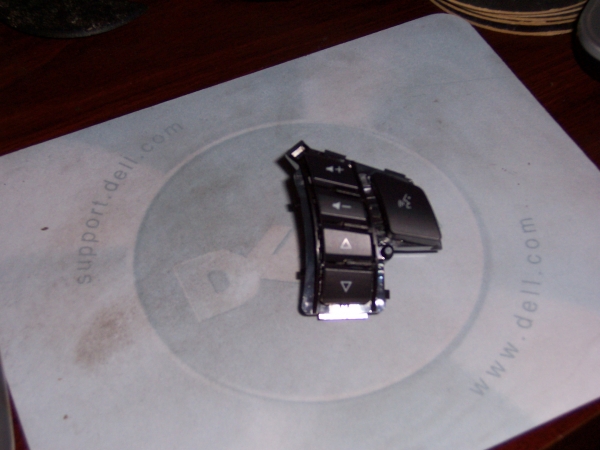

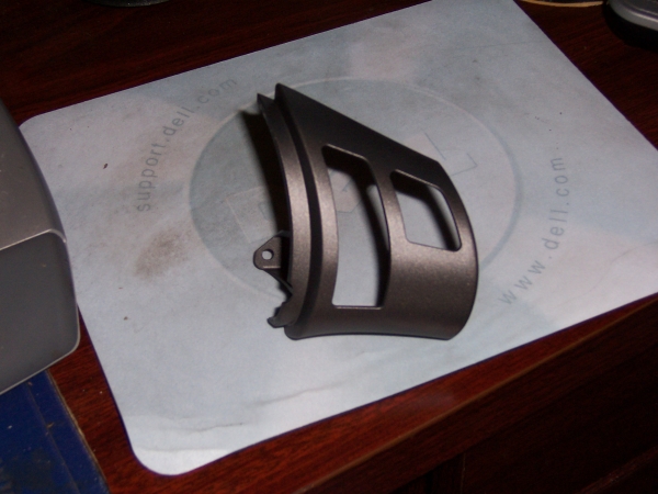

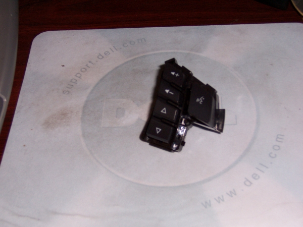

Here's the pics that oneton took and put in his gallery.

Yes this is the new switch for a 07, A little change in style.
The part# for switch 15942446
The Part# for cover 15234337
Wire harness is the same #15234343
The cover looks the same but I think that how the new switch snaps in not??? The cover is dark gray met. If anyone is looking for a 07 cover in this color PM me as this is not the one I need. If you have gray I think it will be right. My wife's has ebony and the covers are sliver. I went by the dealer tonight and looked in the window at one with gray and the looked dark with a gray wheel. The ebony has a black wheel with silver trim covers. The cover cost me $14.87. I was thinking that soom one on here was looking for a darker cover cause the one they got/had was to light in color ??????? don't know for sure
