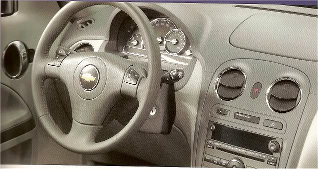

Also the 06 "Details Book" that the GM salesmen study about the vehical has the concept steering wheel buttons.
I like the ones we have now.
YUCK!!!

Old Nov 25, 2007 | 02:01 PM
  #432
courthousedeb's Avatar
Joined: 04-19-2006
Posts: 5,065
From: Arvada CO
Don't like those at all...placement looks weird. Glad we didn't get those.
