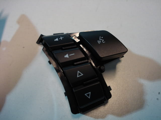

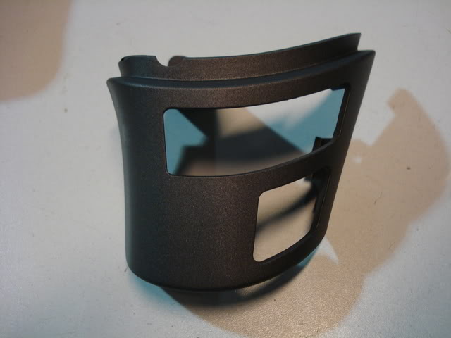

Kawtipping...here's your photos in a larger scale.
Thanks for the bigger pictures. I am not used to having to link to an outside site to post them.
