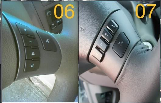

Just read through all of this, and I'm confused. My HHR is presumably an early '07, built 10/06 and bought as new 11/07, it has the buttons with the bevels top and bottom, and a dark grey cover. The pics here in the early posts show the flat buttons, apart from oneton's gallery, which are like mine. What's confusing me is that the 2008 HHR brochure I have shows the flat buttons. Is this the later style? Or is GM being cheap and using old photos in their brochure?
Hello pg318
The 06 Wheel buttons were flush with the bezel.
The 07 Wheel buttons are now raised with rounded edges, speaker symbol added. Only the cruz and mute (large) buttons remain flush. There is also a silver bezel for 07.
Yes the 08 brochure shows the 06 wheel.
See pics for details. Thanks other members for providing pics. I just put them together.

Nice picture joining to show the different Pretzel. Thanks!!! Maybe we can get someone who has radio controls on their 08 to post a picture of theirs and you can join all 3.
