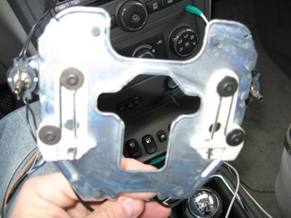

Not sure if anything's different on the '09s to my '07, but mine has the white plastic moldings on the back of the steel plate, and the clips are riveted to the back face. Push the wrench (I used a long terminal screwdriver) in and allow it to slide off the side of the plastic part facing the hole, then while it's sliding along the back face of the plastic towards the center of the wheel, it's bound to contact the spring, it's just a U shaped piece of wire, which doesn't need much pressure, it's just located into a groove around the bullet on the airbag assembly that locates through the hole in the plate. Once the clip disengages, the airbag assembly pops out.

Most useful image unfortunately came out a little fuzzy, I'd reassembled everything before finding that out. This is the back of the plate.

Woot. I finally got it too. Thanks everyone for your help. The white plastic I saw is part of the assembly that holds the metal levers as pg318 shows in the picture above. There is a channel/opening thru that plastic. That is where the metal lever is. I did as Sno White suggested and did one side and then kept it pried open w/ a screw driver. It all installed rather easy. I tested everything and it works. Unfortunately, it appears that bluetooth is disabled or not there in hardware. If you press the audio button for more than a few seconds, it accesses the phone system. If you say "bluetooth" it says "pardon" so, it appears there is something missing in software or hardware. I will have to investigate this further. Thanks again for everyone for your help! I now have a rocking leather steering wheel!!
