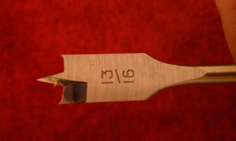

The hole size on the waterfall is 20mm, or 13/16th. I found it incredibly easy to use a spade bit, drilling from the back to the front. It works absolutely perfectly.
Here is mine.
Again, this is exactly the same size as the TC hole on the waterfall, and makes the new factory fog switch look discernible from an original option.
