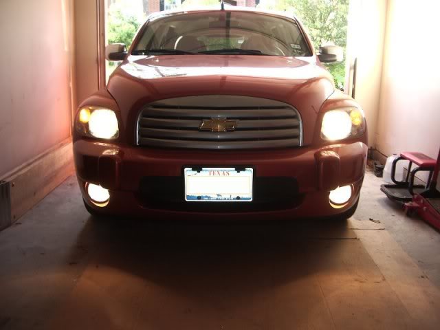

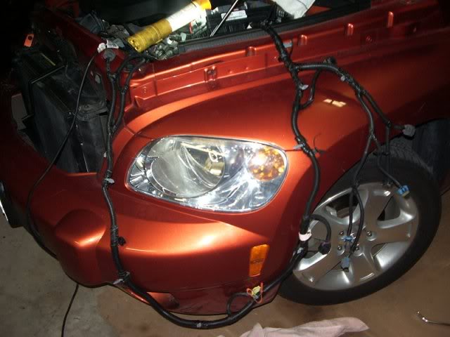

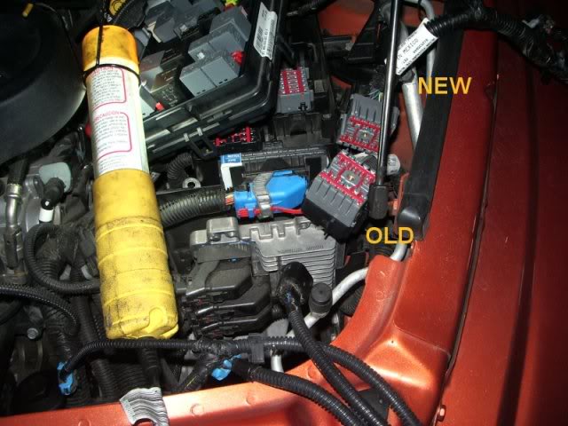

Hello,
I ended up getting the entire fog light harness Used for $50.
It took about an hour to put in.
Very simple ...when removing old harness just follow in with the new one :)
Thanks members!!
Craig~
