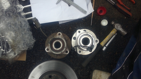

Originally Posted by finnhhr
just update... the pontiac G6 bearings really DOES NOT fit hhr- unlike some vendors have on their site.
It was priceless moment to hold in hand old worn bearing and new pontiac G6 bearing. size difference is like half INCH in diameter... picture in my profile
picture of the hubs from his gallery
