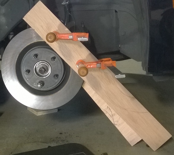

So this evening I did the passenger side on my SS. Basically it was exactly as indicated but for 2 things. I bought a deep 30mm socket and brought that and a 15mm socket down to work on the car. But my SS has a 36mm nut holding the axle and the 5 bolts that needed removing all needed a 13mm socket. Luckily my dad owned a porsche and so I have a 3/4 breaker bar and a 36mm socket. Big though, so I had to take off the wheel to use it. Being lazy I tried this to restrain the hub while loosening and tightening the nut and it worked perfect. Obviously you'll need to move the wood to the other side to loosen it!
