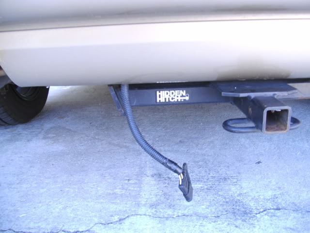

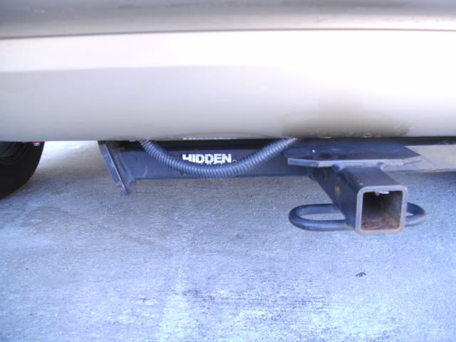

I found a rubber plug/grommet in rear of tire well that wasn't used. So I drilled a hole thru it and ran my pigtail out that way. (did have to cut and splice the wires to get thru the hole and seal with silicone) Enclosed the wiring in a wire loom to finish it off. When not in use I can tuck it out of the way on top of the hitch. Name:  002-18.jpg

I really like the household lamp as a work light source; I’ve always disliked the bright glare of a trouble/shop light.
X2 on the “red” wrapping of the wire.
I like this idea! Much better than closing the hatch onto my wire. I may have to look into this myself...
