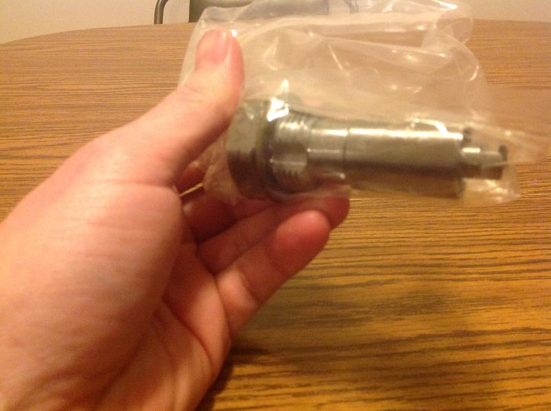

I see a box marked made in Taiwan , so how about opening the box and taking a picture of it.
X2 on Dan's suggestion, replace the timing chain kit!

For some reason it only lets me post one photo at a time. Here is what is in the box. I am definetly going the route of cheap insurance. Other items I am considering replacing are the starter and alternator. Most because they are the original and after 286,xxx miles I cannot imagine there is much life left. I am also trying to save a few bucks though by doing it myself. Not as simple as the 350 in my old 69 but not too hard either. I will have to look back at the paperwork when I had the engine replaced last time. I think I did replace the water pump and for sure know I replaced the t-stat. I will have to make a list and head to the store.
So is the consensus to replace the guides and all now?

That is the new style tensioner, and yes chain guides and sprockets would be a great idea!
