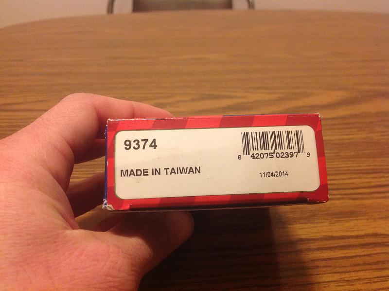

Looking for some tips here. I am replacing my motor for the third time and going to replace the tensioner before I drop the motor in this time. The donor motor is straight out of another 2006 HHR with 94,000 miles on it. I figure replacing the tensioner now should help this motor last another 100k. My first motor gave up after 206,000 miles and the last one only went 160,000 (80,000 by me). So I do a lot of driving. After reading the posts here it seems like the thing to do is remove the front cover and valve cover, remove the old tensioner, install the new one with the plunger compressed and then activate the plunger. The instructions with my new tensioner don't fully jive with that though. I also have photos of the part I bought. It does have an oil galley hole so I am guessing it is the updated part. I should also add that I heard my new motor run before it was pulled at the yard and it started good with no noticeable noises. And I know what a bad one sounds like. So take a look at what I have and let me know if I am on the right track. Hopefully it starts to warm up a little and I can get back at this thing. Almost ready to pull the old motor and then will be ready to drop in the new one. Thanks.
