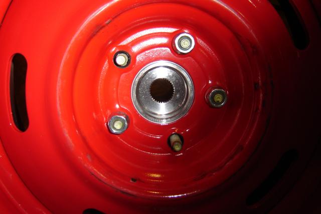

If you dare to trust wheel Vintiques, I would suggest close inspection of the radius near the center of the wheel for cracks. If you do find cracks or other defects, good luck with refunds. I'm giving mob steel/Detroit steel wheels a shot at my business. Will post progress as soon as possible.

I trust the WV's I just avoided any stress issues by using 65.1 mm ID 67.1mm OD hub centric aluminum rings, these take the stress off the lugs and spread it over the 5 studs and the hub just like the stock steel rims.
