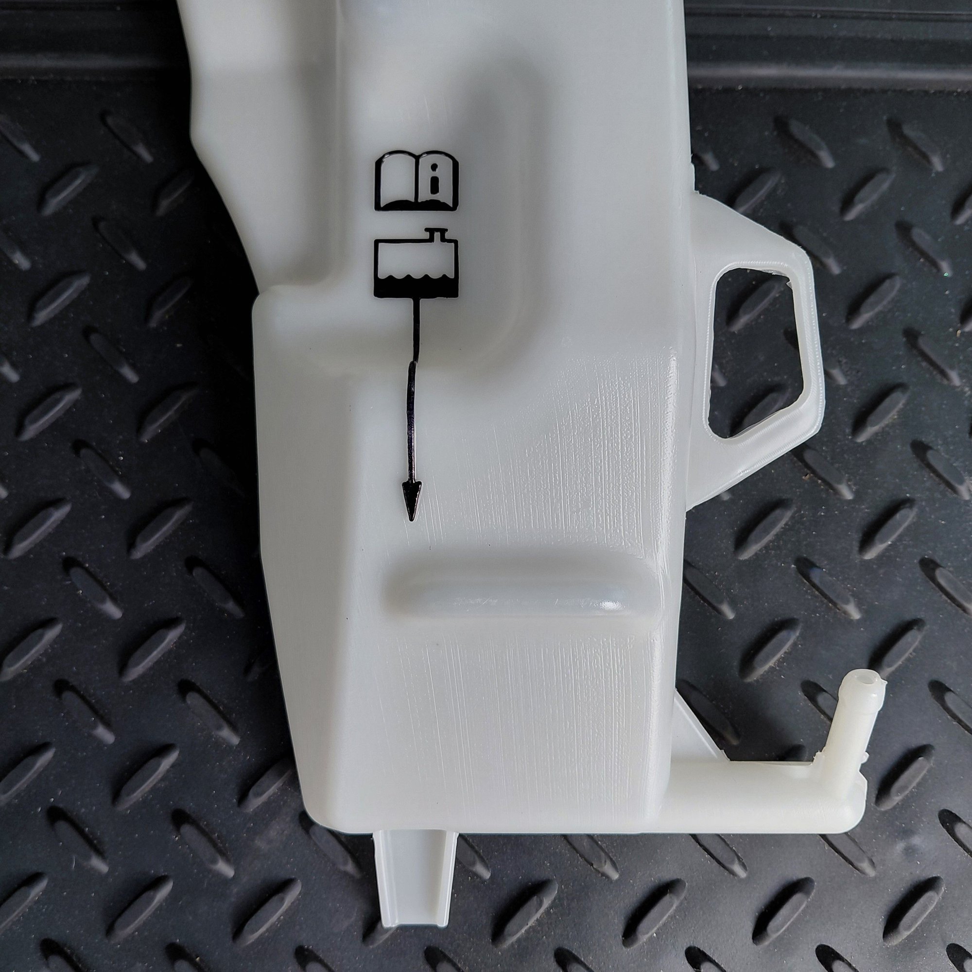

Wow Guys! Thank You Each for helpful explanations & thank you Old Blue for the link for your air purging method. That is something I'll keep in the HHR file. Thanks, tooDon Brew for the photo of the coolant tank. Mine is somewhat different. (2006 with 2.4 non-SS)

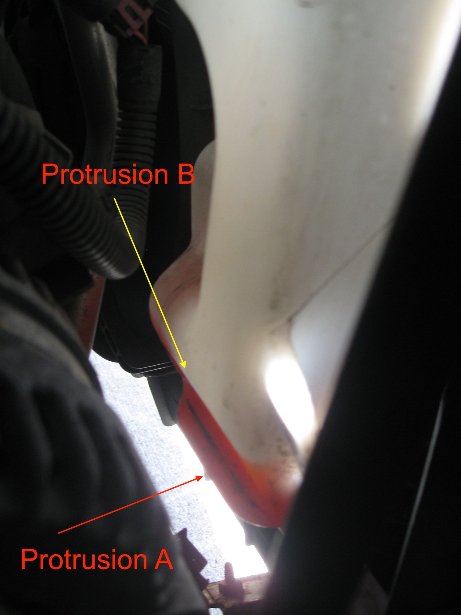

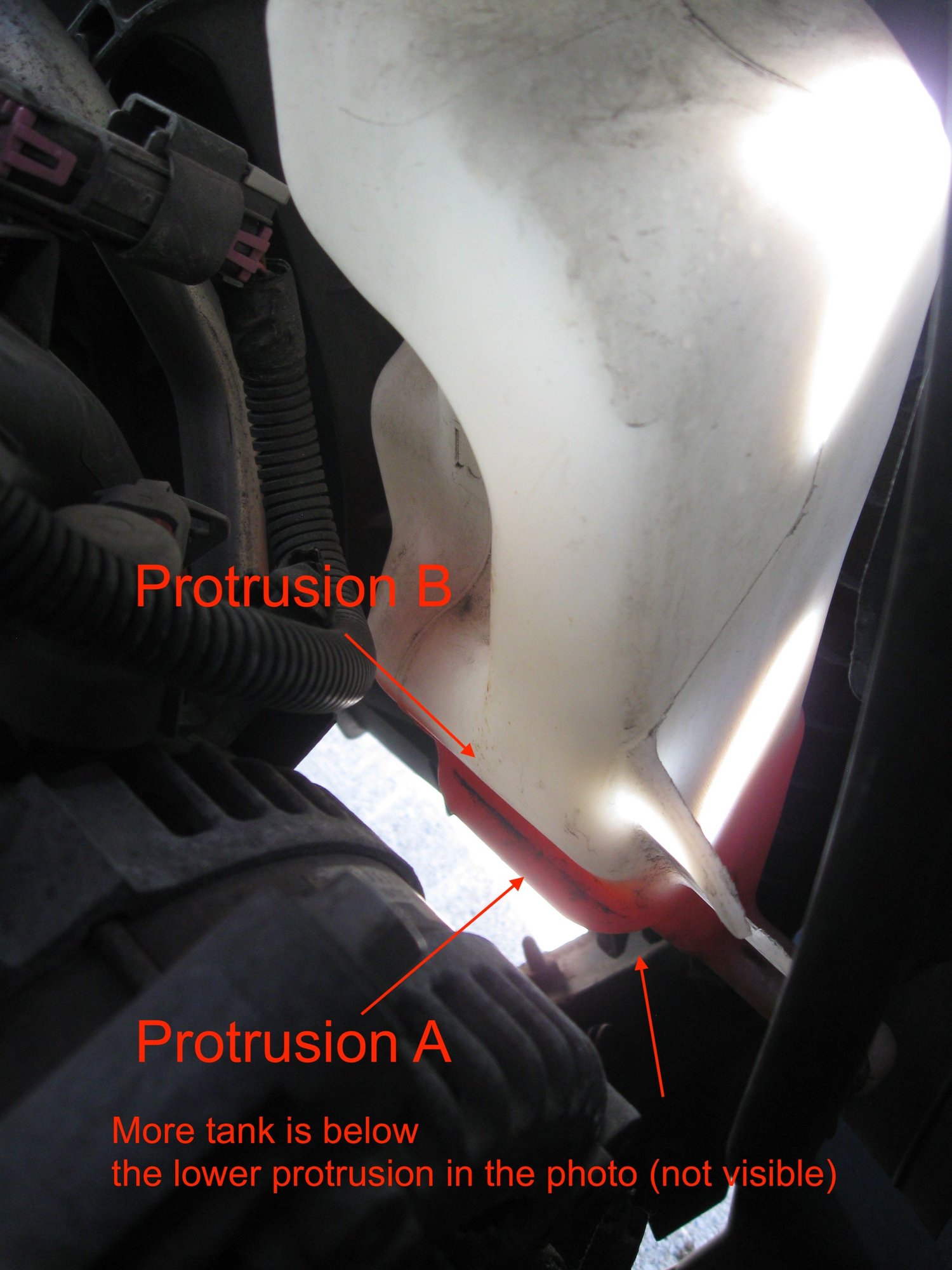

Oddity About My 2006 Coolant Recovery Tank-
My tank is different from the one Don Brew posted. There is a protrusion like in the photo above, but it is about 1-2" lower. About the height of the one in the photo is another protrusion. It's wider and then tank gets thicker above it. I don't know which to choose. For the last days, it has been at the upper one with engine off & cold. Yesterday I noticed the level was up to about 1/2 tank when engine was hot and off.
Below are a couple of photos trying to explain better than my words.
I'll post an update what I find in the tomorrow.
Thanks Again All!
Paul

Old May 31, 2026 | 09:32 PM
Posts: 26,553
The radiator fan won't come on until 219F without the AC compressor.
Same part different side. In fact, I can see the graphic in your pic, almost hidden.
When you add coolant do it at the pressure cap, not the bottle.
2006 is not supposed to have a recovery bottle, it should have a surge tank.
