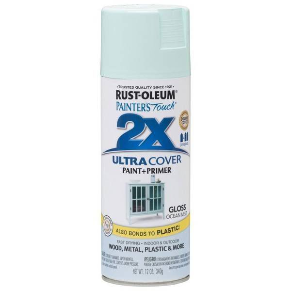

Originally Posted by Oldblue
The coating I sprayed on went foggy and nasty after a couple of weeks.
I seen in post #25 that you used "UV 2X". Can you tell us what this was exactly?
I am going to wet sand and spray mine and did not want to use what you did if it went foggy.
Thanks
Old Jul 10, 2022 | 10:28 AM
  #36
Posts: 40,097
This was the product , I used it in October, so possibly not within the temperature range the instructions suggest
