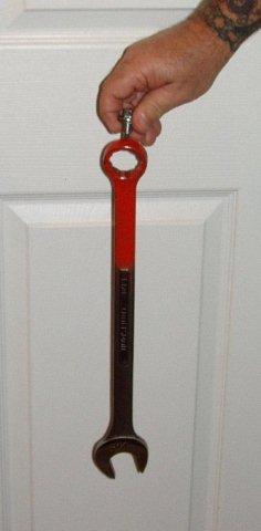

Advance Auto carries the "shorty" 32mm oil filter socket also..
But got my magnetic drain plug off ebay, Yea it can hold a 1-1/4" combo wrench.. Rare Earth magnet..
