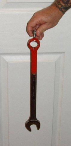

Don't forget to add a magnetic oil drain plug.
Here's mine:
