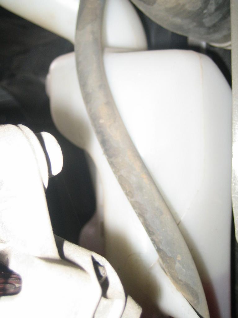

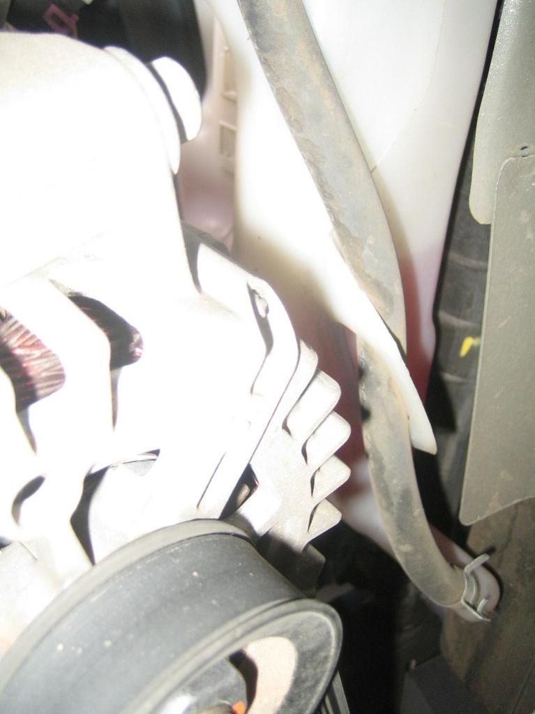

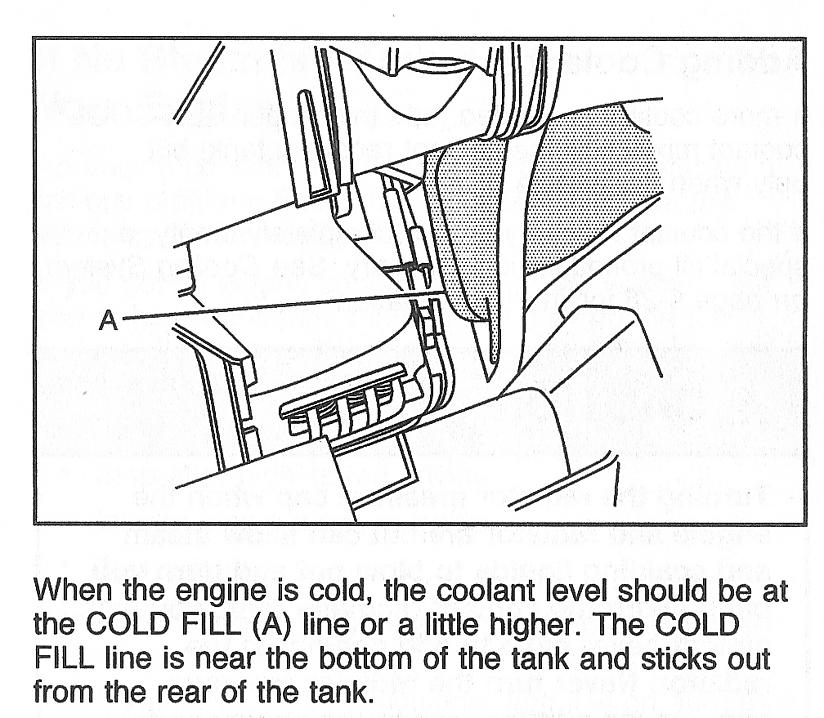

Here is a pic of the coolant level explaination in the User's Manual and two pix of where my coolant level is at overnight cold. It's impossible to see what's on the two embossed marks on the tank itself unless your sitting on the manifold. To me it looks a little low, but then I'm a Newbie with this car.

I guess it would have been too simple for GM to put the cold fill line on the side of the tank with the black hose that faces the front passenger quarter panel.
So to clarify, do they mean the bump just below the coolant icon on the plastic or the other little bump, further down?

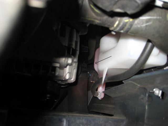

Coolant tank cold level
There is a bulge on the rear side of the tank down low. The photo is taken from on the right side of the car looking down. I usually keep the level up above that by approx an inch as the GM level is so far down. I do that to give me a little leeway if it goes down a bit. You never want it to suck air because the tank got too low.

Brilliant shot! I tried to contort myself to see that and get a photo like yours but could not. Thanks for sharing it.
