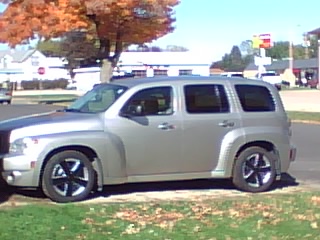

looks great!
almost makes me wish i'd spend less time masking mine off lol
