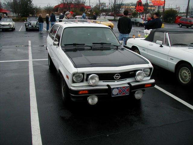

it kinda boils down to this.....if YOU like the extra lights, then by all means, bolt them on and light up the night I personally like more lights as I had a personal experience and now, there can't be enough lights. I drive a 75 Opel Sportwagon with the 7" main headlights replaced with HELLA H-4s, mounted above and below the bumper are CIBIE Oscars both driving and fog units. I know this is a HHR site, but, I have to approve any mods with the wife, as she is the one who has the HHR

On my Opel I didn't want to drill into the bumper (hard to find now) what I did was make a small "L" to fit behind the bumper recoil mounts and come up just under the filler strips between the bumper and the body. They are securely mounted, but the mounts are not visible. You might want to do a search on removing the front facia, and just for the ability to see what's is where and how close, you might want to remove the facia and take some measurements.
