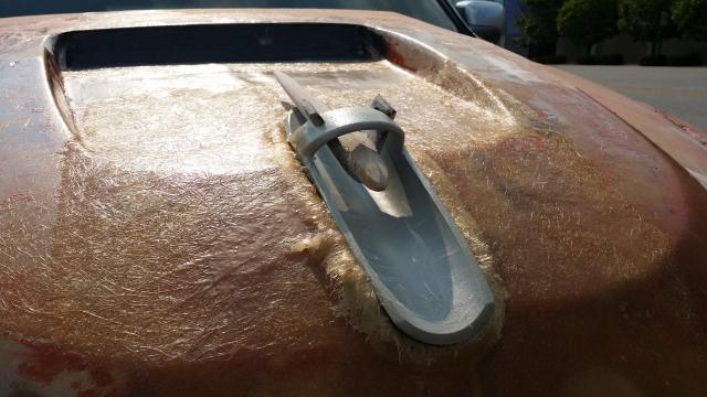

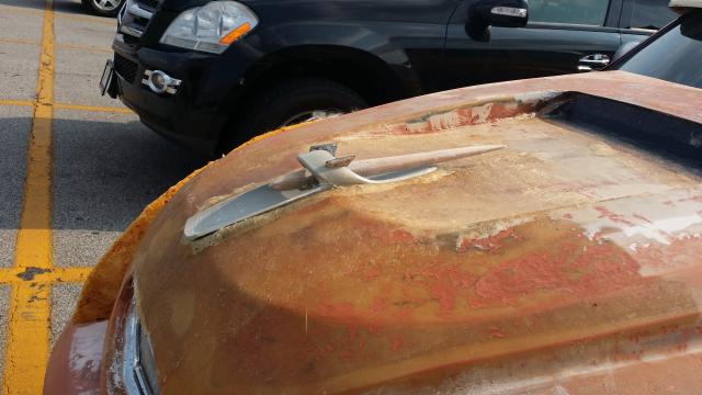

So here is the very rough mock up of the hood ornament. I think this one will work better on the Bijou Super than the last one. Still a ton of cleanup to do, but what do you all think?

Where do you get plastic like that chrome plated then?
Old Jul 30, 2014 | 11:35 PM
  #676
Unless Ben is going to translate the mock-up into metal, there are services that can vacuum plate plastic and fiberglass. You just need to give it some fairly thick clearcoat protection, or the vacuum deposited "chrome"(actually aluminum), will wear off with handlng.
Those of us who grew up in the 60's and 70's remember how the chrome wore off the bumpers of our toy cars and trucks.
And to get away from how to plate plastic, I'm really digging the revised ornament Ben, it's a more cohesive look than the first evolution.
