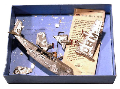

Super Alloy 5 works well Ben, I havent used it to make anything for a vehicle, but I've used it to replicate pieces for toy trains suffering from "intergranular corrosion" or "Zinc Pest".
It's an unfortunate condition where diecast Zinc parts made in the immediate pre and post WWII period self destruct from internal corrosion due to impurities in the alloy.
This postwar toy plane crumbled when picked up, Zinc Pest at its worst.
