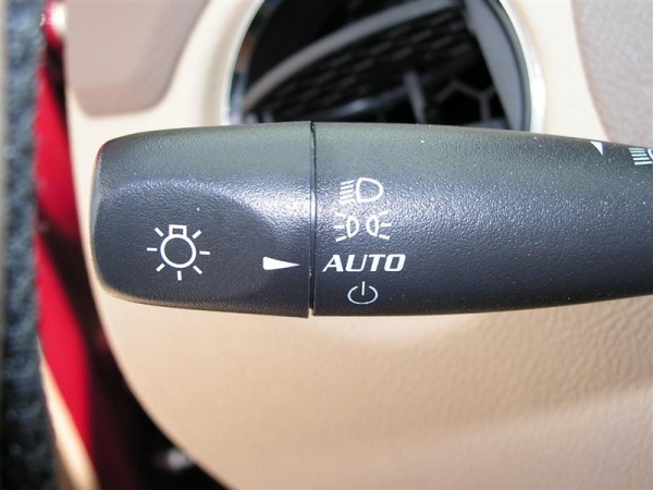

To stop your auto lights turn this down
and you D.I.C. will tell you that your Auto Lights are off.

that resets every time the car is started, however i think you can set auto lights to off in the dic.

Just checked and you can turn the auto lights on off on the DIC. it is one of the last items on the list.
hold the bottom 2 buttons down for a couple of seconds, let go
cycle thru the DIC w the next to bottom button
change w the bottom button
Personally, i like the auto lights. when i park i just turn the knob back to me and turn them off
