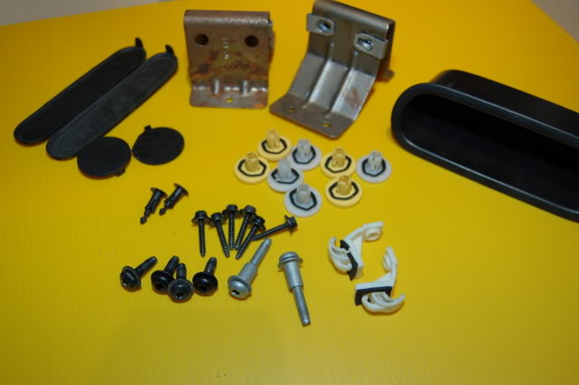

This is Most of the hardware, Minus the 6 little push in Nut Clips needed for the handle mounting hardware. That pair of steel brackets you see in the pic here. 3 nut clips are used for each. Those steel brackets attach to the door, then the door panel attaches to them with 2 screws each in the finger cups used to pull the doors closed. The 2 white Hooked looking clips are just Extras already in place on the rear doors. So are the white and yellow pieces, already in your doors.
Mainly you need the 2 steel brackets, those 4 round head screws, the 6 screws you see, the 6 nut clips not shown, the 2 finger cup rubbers, and either rear door lock covers or get the lock buttons as filler.
BTW, those 6 little nut clips are about $24.00 from the Dealer. So for anyone wanting to add rear panels, Try hard to GET these little pieces with your used door panels. They Add up Fast when you Need to get them later at the Dealer otherwise.
When I bought my door panels from a member on another HHR Forum, I asked for ALL the clips and parts Needed for the install explaining exactly what I was planning on doing, he gave me everything but thought those 6 clips were already in a Panels rear doors, GM did not put them in as there not needed in a Panel. He would have sent them after we found out my Panel did not have them, but it was just easier for me to run over to the local Chevy Dealer and get them the day I was swapping out the panels.
