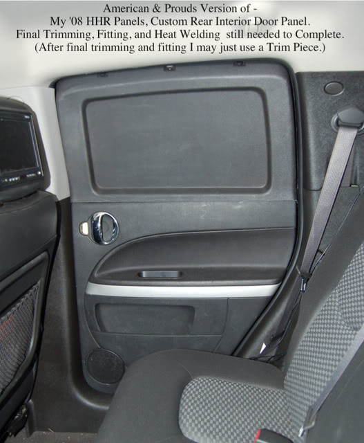

Work In Progress Here.
My version of a Panel's rear door interior panel once a rear seat has been added. Still have some finish trimming to do, and I might fully Heat Weld the seam to make it fully one.
I bought '08 rear door panels from a windowed HHR in early Fall last year, and Finally was able to locate the rear Panel interior panels a couple weeks ago. (I wanted to SAVE my OEM Panels in case I did not like how this Mod ended up turning out, and as with every Mod so far, I can go back to factory Original if ever needed.)
It is looking good so far, once I finish trim it out, I may Heat Weld the seam, then re add the texture along the welded seam it should Blend in as one. Giving it a "OEM" Factory Look. If the Final Trim looks good enough I may just add some type of trim piece along the seam.
I'll decide how far to take it once I get both sides fully trimmed out.
(It has been about 25 years since I have done this type of a Custom job.)
(Also Notice I have not installed the rear Black Leather seat yet. Tearing out the whole interior to soundproof and upgrade the audio and video systems as soon as my speakers get shipped and we get over this constant daily raining. So I will install the leather one after the interior work in done.)
